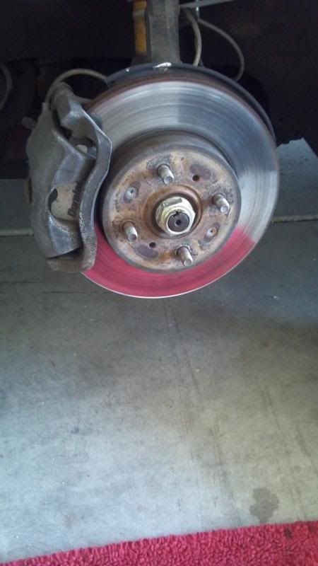

Obvious step, remove wheel.

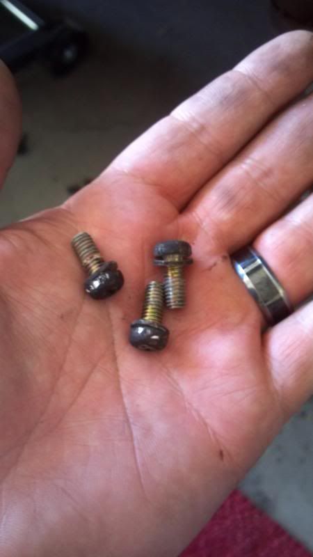

I recommend drilling out the two screws that hold the rotor on at this time. Make sure you drill deep enough because if you don’t you will have to grind any residual material from the hub otherwise the new rotor won’t sit flush. Secondly remove brake line from stock caliper and tie it back out of the way.
Remove stock caliper, two 12mm bolts in the back
Remove stock caliper bracket, two 17mm bolts in the back

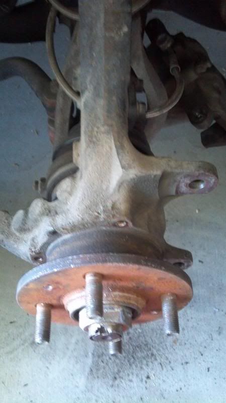

Remove stock rotor, the fronts fell off but the rears I had to PB blast and hammer time.
Remove dust shield. To do this there are 3 phillips head screws behind the hub. I didn’t have a special screw driver to take them off so I used a vice grip on the head and loosened them and did the rest with my fingers. To get the dust shield off at the narrow part I used a pair of wire cutters and man handled it. Mostly for lack of proper tools. You can see the holes where the screws were in the picture.

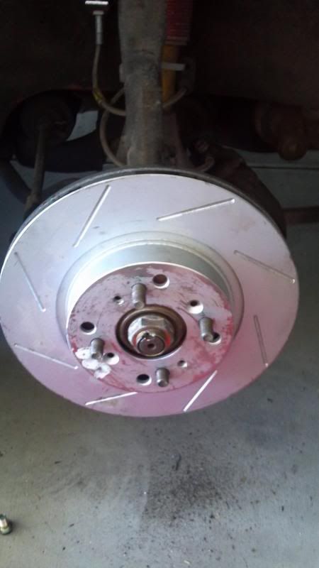

*clean the hub mounting surface well before mounting new rotors. Any rust or junk on that surface is a bad thing. (THX Andrew)

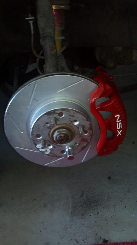

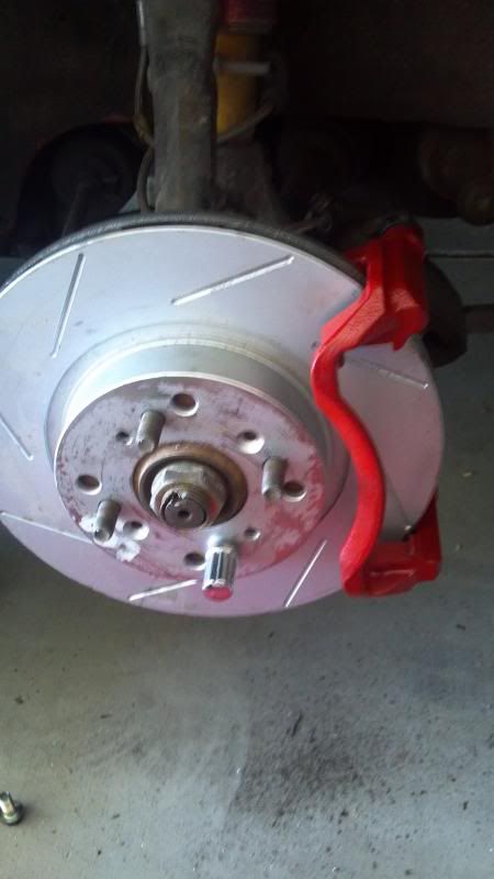

Put on new rotor and hold down with a lug nut.

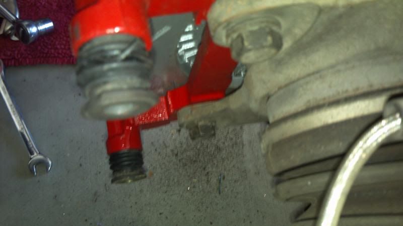

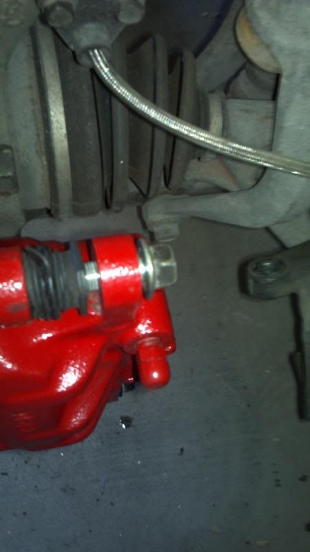

Use 5g prelude caliper bracket (ordered from ebay), mine didn’t come with the plungers but I used the ones from the NSX caliper brackets. The trick to pulling the rubber boot out without tearing it is to separate the plunger from the rubber boot, pull out the plunger and stick a small screw driver inside and pop it out.
Install rubber boot into 5G caliper bracket and then the plunger. Use 3g prelude bolt to bolt the caliper bracket on.
Use NSX caliper bolts to bolt on the caliper.
At this point spin the rotor and verify smooth operation. I didn’t have to use spacers to adjust the center line but this doesn’t mean you don’t.
Install brake pads (I used OEM pads)
Bolt on brake line and bleed the line.

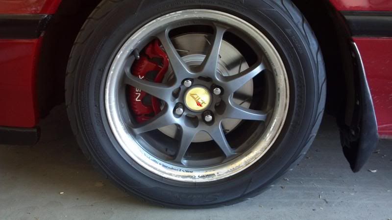

Yes my rims are 15” and this set up fits.

#2 ·
Those of you following along close enough will notice these are pictures from the left and right side. I kept forgetting to take pictures as I was working. Also you will notice the stock caliper still attached to the brake line. Lesson learned, take the line off before you remove the caliper, its much easier.

On my one run the wheels didn't lock up but it could be due to not going very fast or pushing hard on the peddle. I would have a hard time believing any one thought the coolness factor of the OEM is far superior to the NSX calipers! ;)

Curious to see a head-on pic though to see how the calipers line up
The NSX calipers lined up pretty dead center.

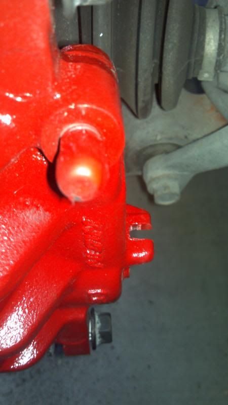

#23 · (Edited)
Fastbrakes rear kit with OEM calipers
This kit was really easy to install. I did notice the washers that came with the kit needed to be spaced differently from the left side and right side. For example on the left, it was one washer, hub, washer, caliper bracket. The right side didn’t need the washer between the caliper bracket and the mount on the hub. So use common sense.
The pictures are pretty self-explanatory and removal was the same as for the NSX set up. I painted the calipers while still on the car mostly because I didn’t want to bleed them and I don’t have the room to have my car sitting for a few days. I did remove the caliper brackets to be painted.
The NSX parts were painted ahead of time so I removed the rear wheels first and painted those parts, then, I swapped the fronts while the backs was drying. Over all it took about 5 hours to do all four corners. I know it can be done faster but 110* temps require mandatory brakes now and then. Let me know if there are any questions.

Put the rotor on and hold in place with a lug nut.
