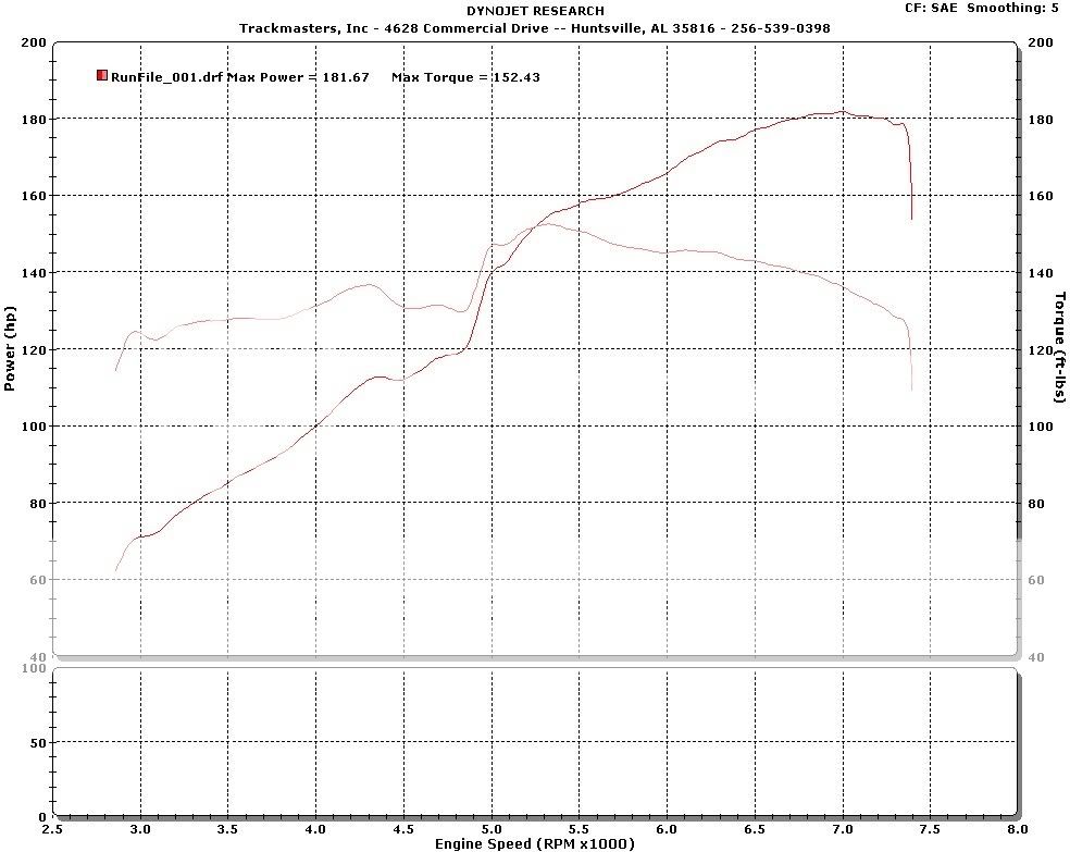

#29 ·
my original numbers with the new numbers... not bad at all
156 whp to 181whp
134 wtq to 152 wtq
