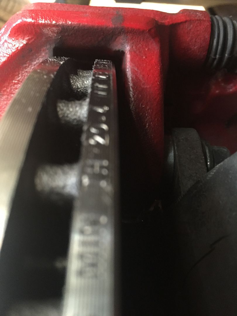

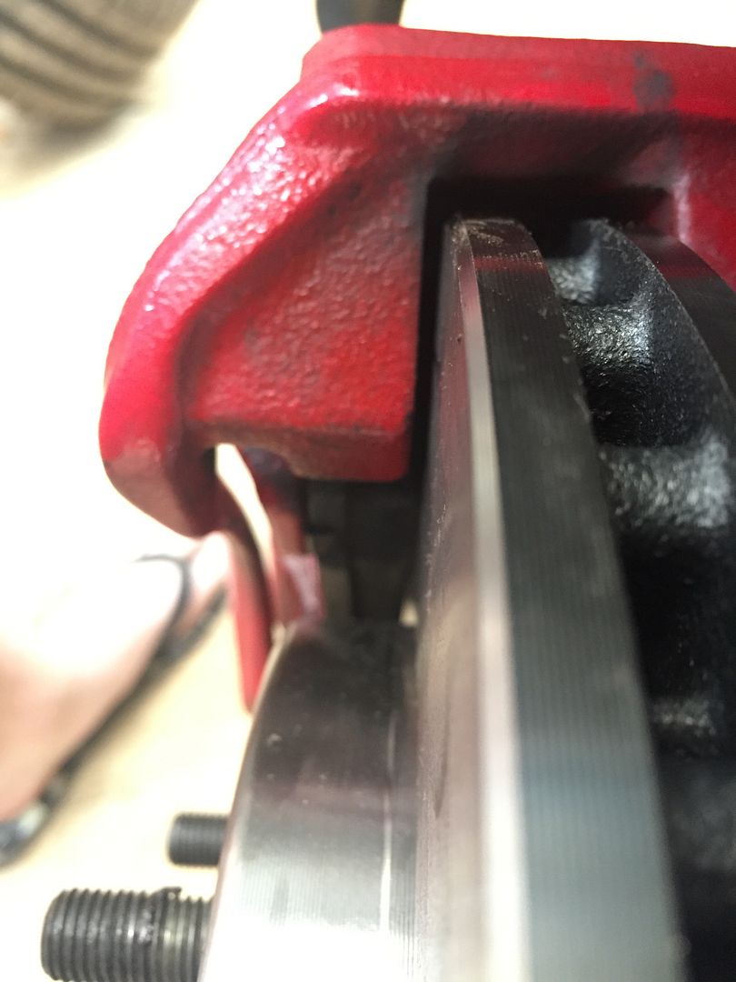

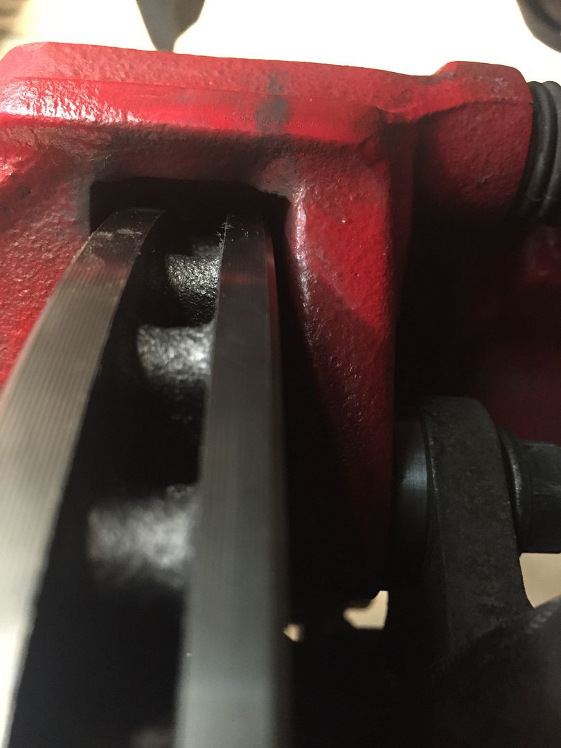

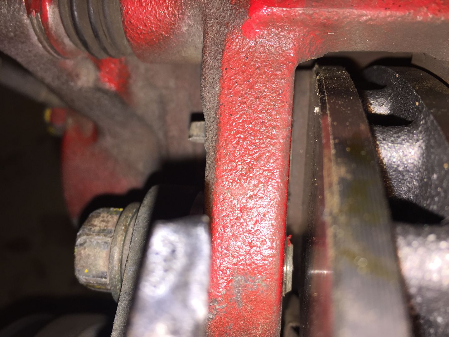

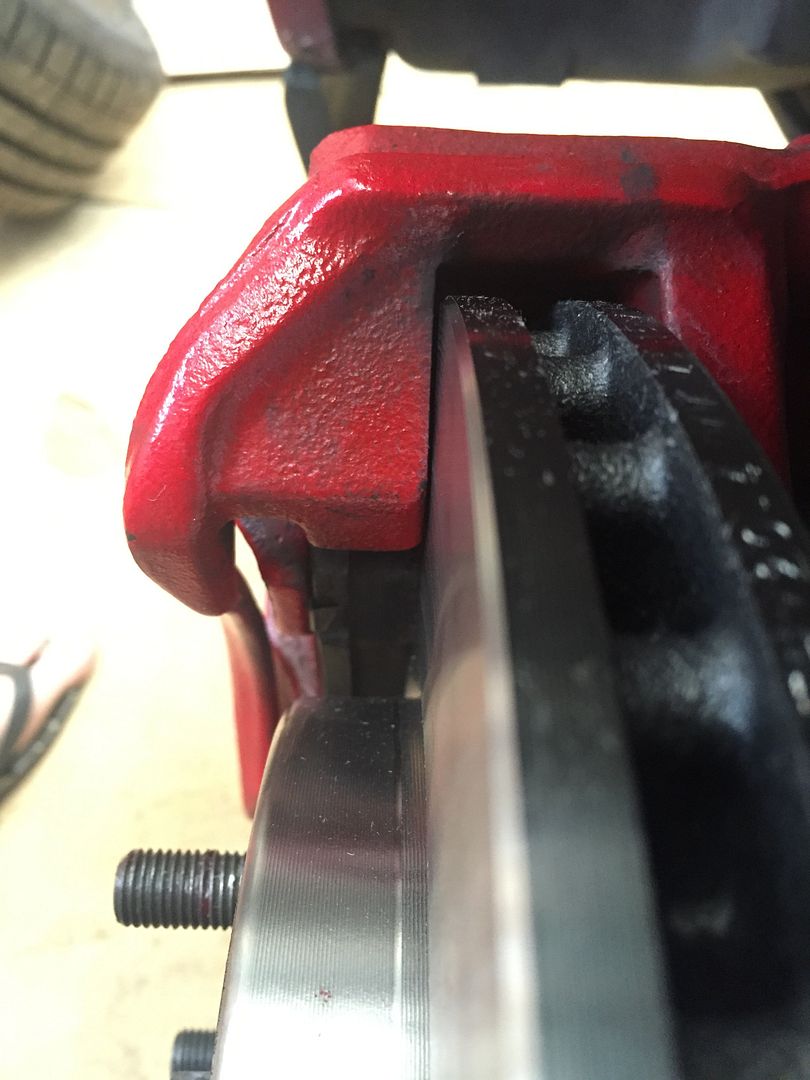

Here is the disc clearances once installed, and it clears just perfect with not touch at all:

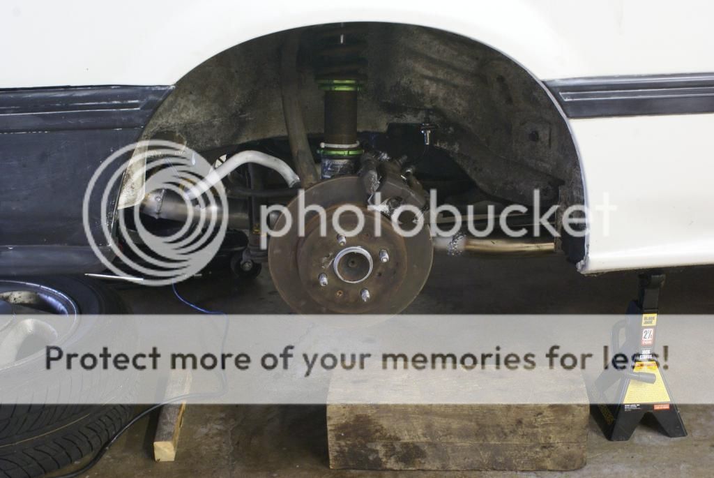

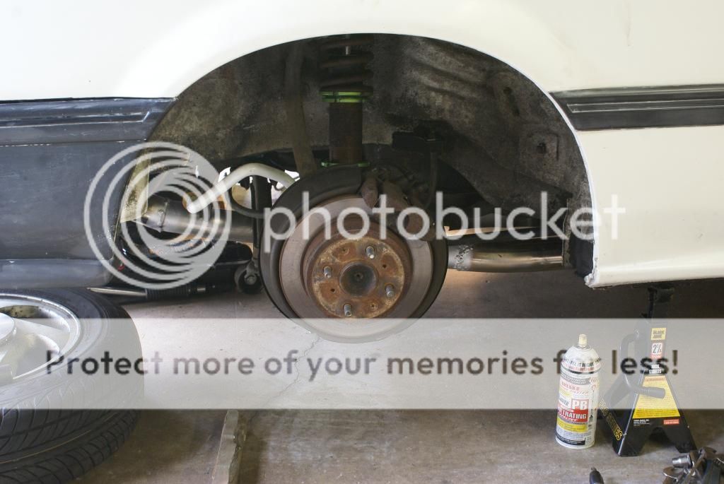

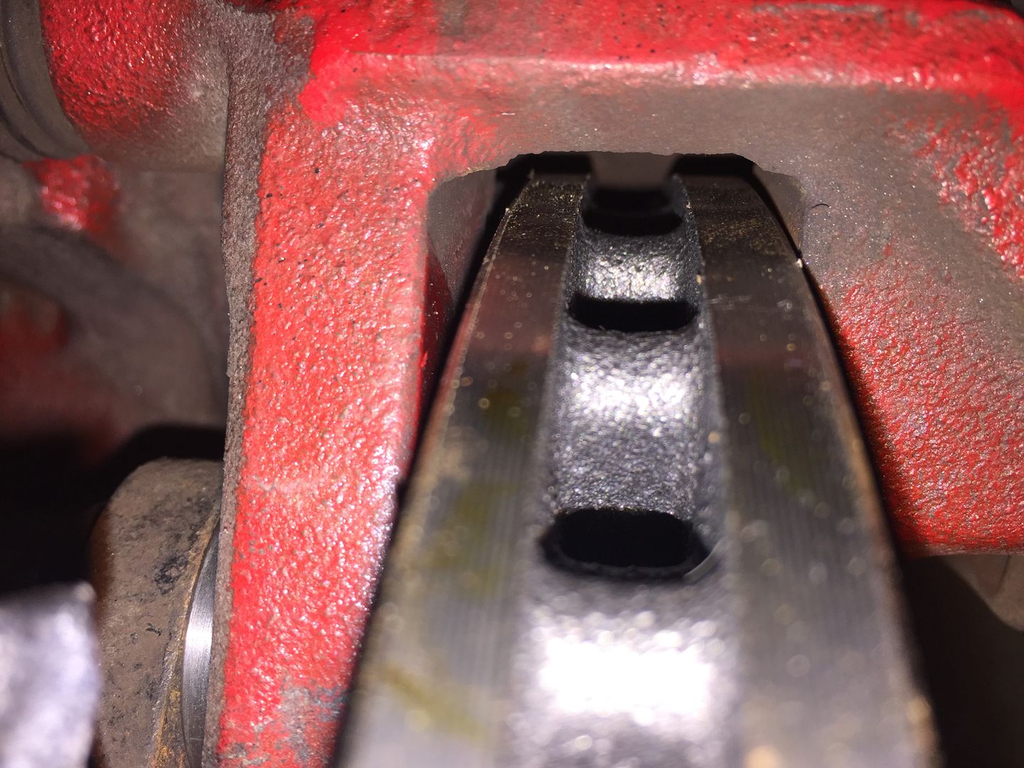

Rear Big Brake Upgrade that allows you to keep the parking brake:
1 . Purchase 2002-2003 Civic/RSX Rear calipers with the mounting bracket. These will bolt right up to our rear knuckles.
2. Purchase the rear rotors which are also 4x100 lug pattern and also are 10.25" in diameter.
3. Purchase 2002-2003 Civic/RSX brake pads and install no modding necessary
4. Remove the rear knuckle dust shield because it will rub against the rotor and calipers.
5. Mount as normal. The EP3/RSX OE caliper bracket will bolt to our knuckle and then mount everything back up. The dust shield needs to go due to the spacing of the rotors and calipers, other than that, this will allow for a 10.25" Rear brake upgrade while keeping parking brake.
Finished result - "pictures from - Lorenzo DiSante"
Rear 2002-2003 EP3/RSX caliper no modding other than removing the rear dust shield.
