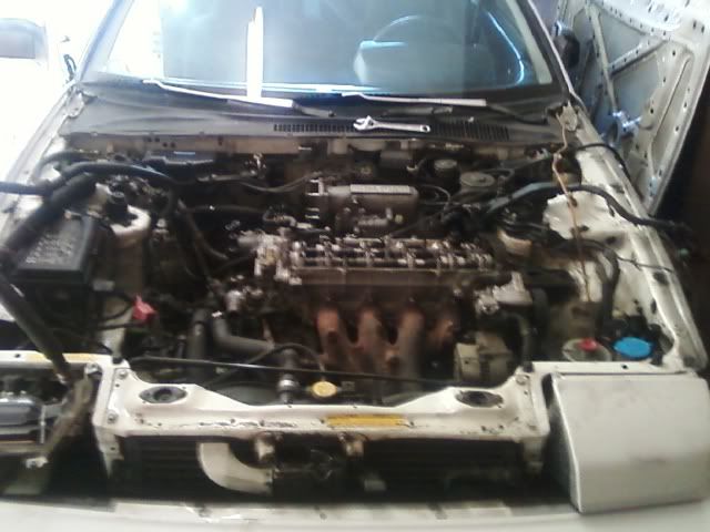

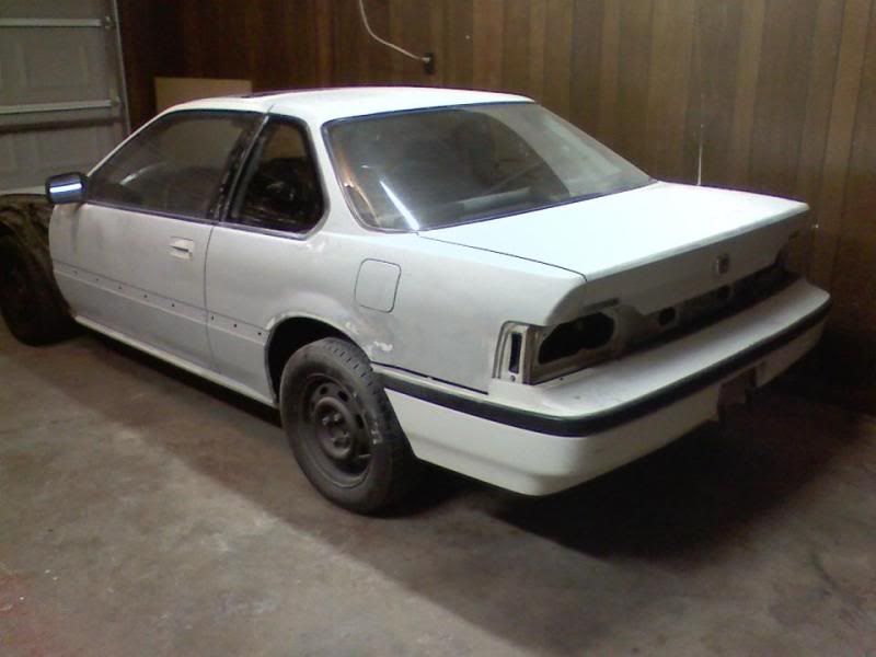

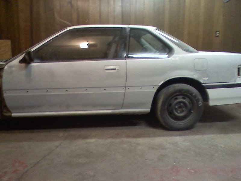

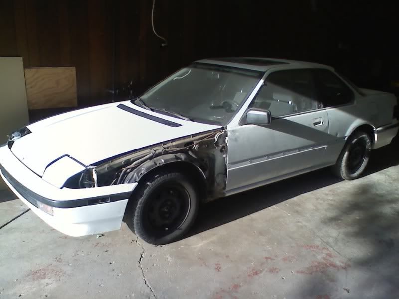

i know im probably gonna catch some crap for starting this thread and not having anything very worthwhile done, but i need to start somewhere so im not posting up a million pics and whatnot when im done and so i can show some progress... so heres my plan, a championship white lude with a 300 whp engine running boost. planning on starting with tokico blue suspension, irotor slotted and drilled rotors/ceramic pads. gonna get low compression forged pistons along with forged rods and a mild bore yatta yatta yatta more details when it all comes along. but heres what i had to start with...
the car was hit by two deer and the hood is messed up along with the drivers site quarter panel and passenger headlight housing. i already picked up a new quarter panel and headlight housing but to prevent this car from rusting any further i decided to go ahead and start to primer it since it will not be painted for another year or so... so time to start body work

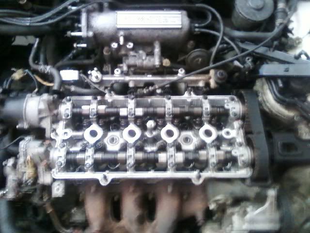

then i wanted to get my valve cover off to clean it up, it looks horrible and dont have any picks right now but the head sure does look awesome
now time to start my first engine pull and wow... is about all i have to say since im such a noob at this.

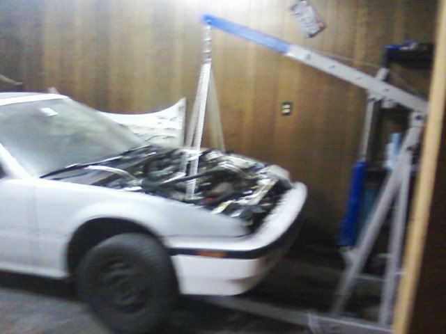

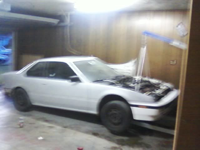

lol Are you picking the hole car up by the cherry picker? Good luck with your build.
#4 · (Edited)
yea we got it up and on to jack stands cause the jack we had took a crap on us, we were gonna get the engine out but we couldn't get an axle socket since everywhere was closed so hopefully tomorrow : )

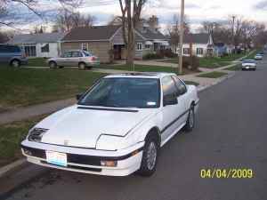

alright, well it may have seemed like i had fallen off the face of the earth after getting rid of that shell. Which i kinda did for a bit, i now have a b16 crx that i've had for the past couple years. Then there's this little sweetheart i picked up in April/May.
Then just a few months later turned into this. Still Planning on doing the turbo build with this one but really it's going to be a while cause i'm going to give the car about every supporting modification possible before i pull the motor and put all my money into that.
