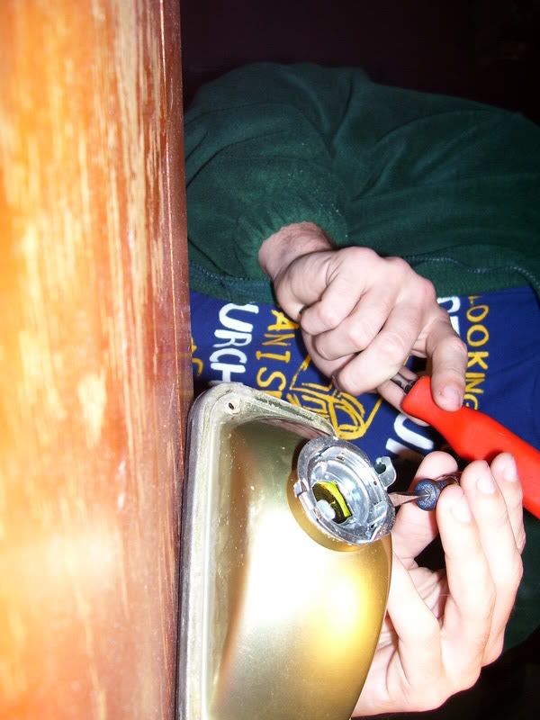

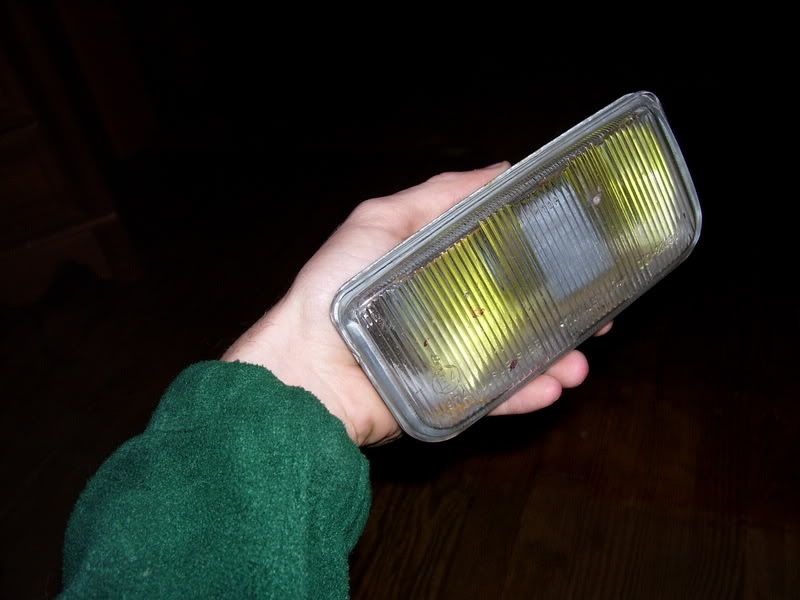

first, get 88-89 foglights.

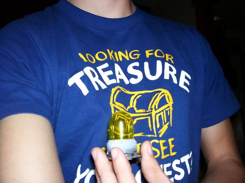

then pry off the part which holds the bulb in place, i used a tiny flathead screwdriver, and hit it with another screw driver head, kinda gently.
then you get the yellow part out.
then i did the same steps for the 90-91 foglights.
then i placed the yellow part into the 90-91 foglight, gently hit it back into place (make sure to put it in the right spot)

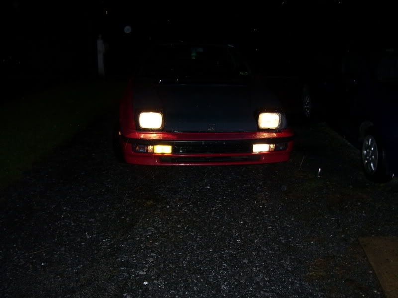

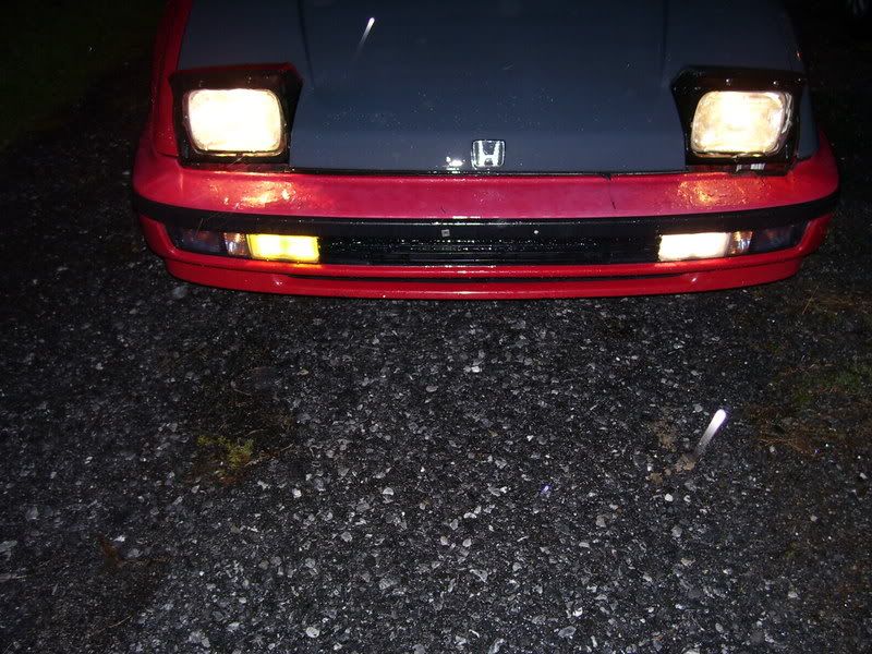

then hook em back up. and you get this...
mine are a lil dark cuz of the tint i think? i may pry it off but im not sure yet, i gotta get a photoshoot with RCH022 lol.

oh forgot to say.. on your 90-91 fixtures, you can take it out and it becomes 2 peices, and inside the whole thing is a "spoon" so to speak, cut it off, gives you a little more brightness... i did it, looks a little brighter, not much, but enough to piss people off im sure.
