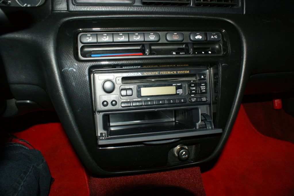

Not the best write up but since there was none I wanted to make one and was really easy :p

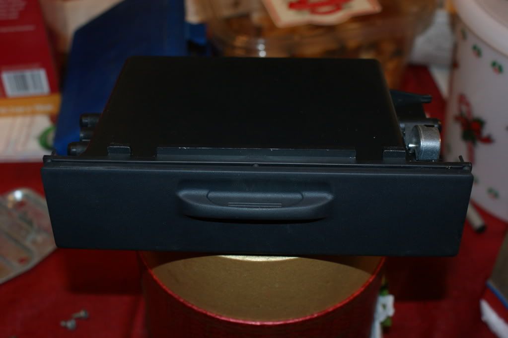

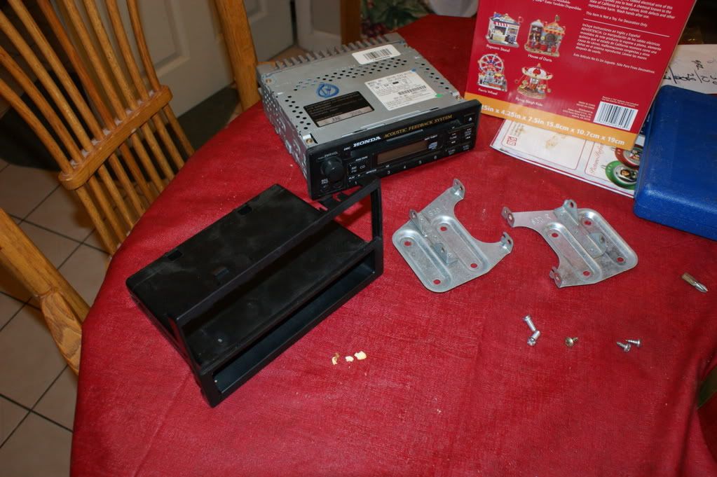

You can pick up this Accord Pocket at any Local Honda Dealership and is from a 98-02 Accord LX
Tools
-Sharp knife
-Butter knife
-Scissors
-Screwdriver
-4 5x12mm screws
Can also use a razor or dremel
1st-Wrap your Butter knife in paper towel and remove radio bezel
2nd-Remove radio and unplug antenna and plug
3rd-Remove all screws on the radio/bezel and take it apart
4th-Take the outer bezel and remove all the tabs

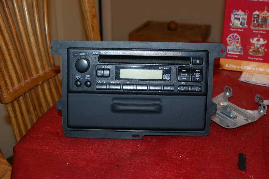

5th-Test fit

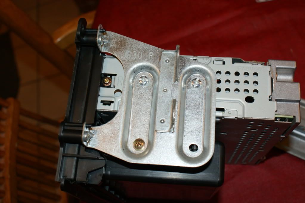

6th-Screw the metal brackets to the pocket and the radio

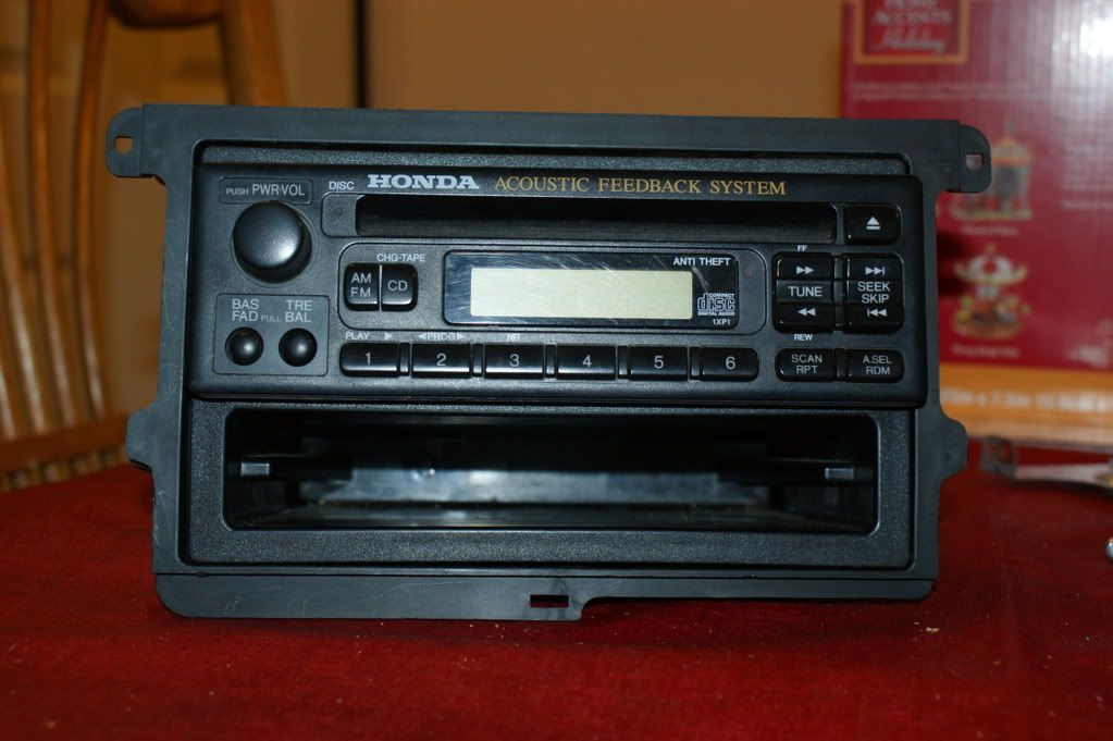

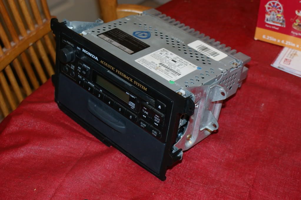

7th-Plug back in antenna and plug and put the radio back in
8th-Put back on the radio bezel

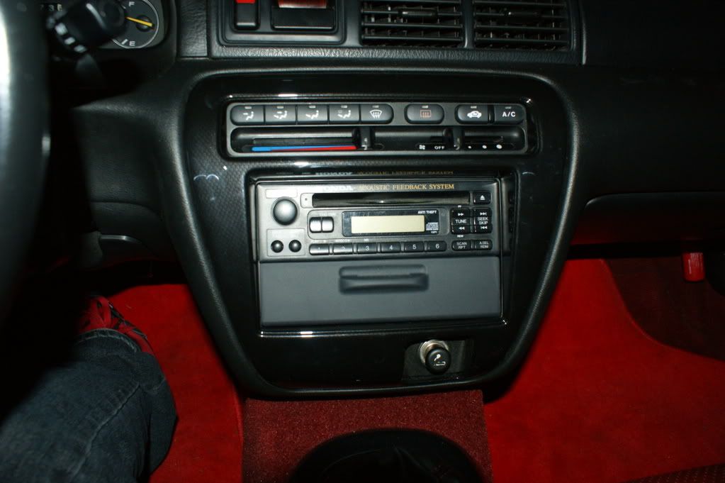

9th-You are done

props dude. im doing this this summer. gonna put a s2k start button behind that door :D...repped dude. thanks for the write up
edit: do you think the s2k button will fit in it?

I like your red interior where can I get me one of those :biggrin:
417 Posts
Does the color match well? From some photos looks quite a bit greyer, then others looks like a perfect match..
I hate my pocket, and like this write up.
it comes in 3 colors: ivory, classy gray, or quartz gray.
jdlude: do you know which color yours is?
p.s. nice jdm cluster..

Thanks and I dont know what color it is?? But I did notice that my friends EM1 had one in a Gloss black
ooh nifty. might have to do this.
how much was the pocket?
I bought it for $31
