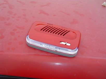

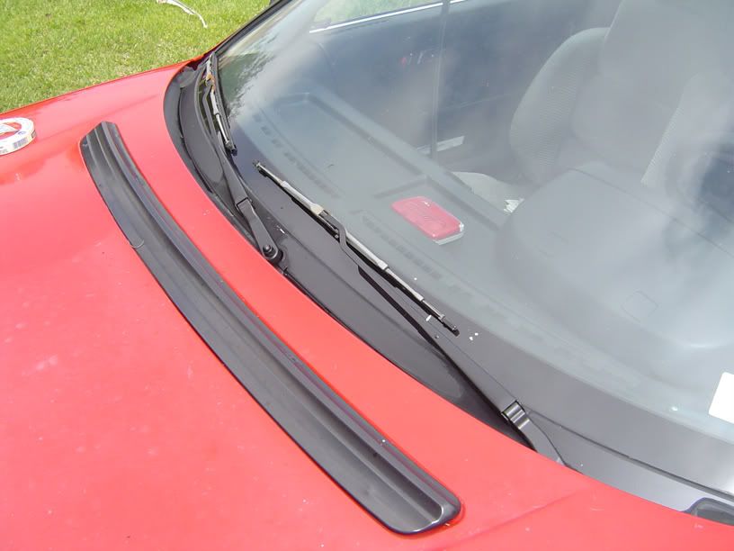

I dug up some old pics of my paint because I forgot to take before shots:
^^^ That's not wet. Those are permanent water spots! My hood, roof, and trunk lid were like that, and the hood was the worst: It was faded almost to white right above the exhaust manifold!

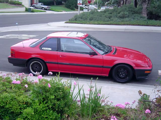

7)Stand back and admire your handiwork:
Night time is the true test of how good a job you did. I was pretty proud of myself until I saw the swirls at night under spotlights :( I'm pretty sure it's because I started at too low a grit. I'm going to buff again next time I wash the car, and use a clay bar. But the difference, even with the swirls, is astounding. Your hand glides across the surface like it's glass, and cruising around just before sunset, you see people putting their shades on when you roll by :D
