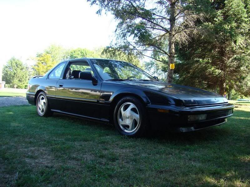

91 Si 4WS
Bought in Central Ohio, drove 12 hours back to my home in PA.
Paid: $2500
The day i got home...
Current shot as of 6/15/09
Modifications:
Suspension:
17"x7" Replica wheels w/ 225/45's 1/28/09 --> http://www.preludepower.com/forums/showthread.php?t=275503&page=42
15" Kosei K1's (old wheels) w/ Toyo Proxies ---> http://preludepower.com/forums/showthread.php?t=275503&page=23
14'' sawblades w/ Falken tires.
H&R race springs
Tokico struts
Mustardcat front & rear STB's --> http://www.preludepower.com/forums/showthread.php?t=275503&page=8
Secluded Performance Adjustable Rear swaybar Endlinks
4 New upper & 4 new Lower ball joints.
Whiteline Anti-swaybars - *soon to be installed*
Interior:
HKB hub adapter
Sparco steering wheel --> http://www.preludepower.com/forums/showthread.php?t=275503&page=57HKB hub adapter.
Custom short shifter
Black interior swap --> http://www.preludepower.com/forums/showthread.php?t=275503&page=2
Engine:
JDM B20A swap ----> http://www.preludepower.com/forums/showthread.php?t=275503&page=52
D2a4 trans w/ a chromoly 9.5 pound gsr flywheel & stage 1 clutch
ESP b20/b21 engine mounts ----> http://www.preludepower.com/forums/showthread.php?t=275503&page=51
Hedman (chikara) header. (pk3) 1/2 way down page ---> http://preludepower.com/forums/showthread.php?t=275503&page=18
B21 Intake manifold swap (pictures) 3/4 way down page...---> http://preludepower.com/forums/showthread.php?t=275503&page=18
Thermal catback exhaust. Installed 10-18-07 --> http://preludepower.com/forums/showthread.php?p=1479896#post1479896
Integra CAI.
Upgraded grounds
Battery relocation --> http://www.preludepower.com/forums/showthread.php?t=275503&page=8
Optima batt.
Custom airduct & air box. (in the works) ---> http://preludepower.com/forums/showthread.php?t=275503&page=18
A/c system removal.
Exterior:
4th Gen Prelude JDeeM Yellow fogs. 12/23/08 ---> http://www.preludepower.com/forums/showthread.php?t=275503&page=37
Subaru Imprezza Sidemarkers. 10/10/08 ---> http://www.preludepower.com/forums/showthread.php?t=275503&page=34
Mk2 VW GTi lip7/23/09 http://www.preludepower.com/forums/showthread.php?t=275503&page=55 dibs- luxlude
95 Accord ex rear lip 9/28/07 --> http://www.preludepower.com/forums/showthread.php?t=275503&page=6
95ish Accord EX side skirts installed 7/8/08 ---> http://preludepower.com/forums/showthread.php?t=275503&page=28
THule roof Rack. 5/26/09 http://www.preludepower.com/forums/showthread.php?t=275503&page=48 dibs - luxlude
Oem Full Bra. (uninstalled)
OLD LIPS:
'93 Volvo 850 front lip. (_ old lip_)1/20/09 -->http://www.preludepower.com/forums/showthread.php?t=275503&page=40
1st gen integra lip.(_old lip_) installed 3/11/08 ---> http://preludepower.com/forums/showthread.php?t=275503&page=19
H22/ turbo Swap parts....
AZ Race Mounts -
Az race traction bar-
H22 - $600
M2s4 trans - $350
Alternator- FREE.
Exedy clutch release bearing - $35.36
4th gen 5spd. Shifter assembly & Shifter cables - $10
PRI H22 swap axles - $400
Wiring -
Ralco rz- crank, p/s & alt. Pulley kit. $170.00
Manual tensioner conversion kit - $178.00 X2 kits. Both cars.
New Honda water pump. - $115
TURBO PARTS
Turbo- Holset hx35
Manifold- custom short log
Wastegate- xspower 46mm
1.75" dumptube
3" downpipe
(ALL ITEMS IN RED FOR $650)
Phearable socketed P28 w/ turbo h22 basemap and blank chip $150
CX Racing Intercooler $100
Tial 50mm BOV $150
B&R turbo coolant line kit. $100
Go Autoworks- -6AN Fuel line from the tank to the fuel filter
Go autoworks- -6AN fuel line from fuel filter to fuel rail
AEM red fuel filter
AEM fuel rail
(ALL ITEMS IN BLUE $250)
Injectors-
Turbo timer-
Boost controller-
Boost pipes-
Other misc. upkeep records:
-Rear motor mount bolts - 2/11/08
-Coolant Temperature (TW)Sensor 2/21/08
-Other coolant temp sensor- switch interruptor. 3/20/08
-Thermostat gasket 2/21/08
-Upper rad. hose 2/21/08
-Lower rad. hose (using a modified 4th gen lude) 2/21/08
-Radiator from my parts car 2//08
-clutch fluid reservoir (old one was leaking) 2/23/08
-b21a (pk3) intake manifold swap 3/7/08
-T/b gasket
-I.manifold gasket
-E.manifold gasket
-Front and rear cat gaskets
-(hedman header) y-pipe gasket
-upper coolant port housing gasket
-Cylinder (CYP) sensor o-ring.
-swapped slave cylinder 4/7/08
-New distributor Cap & rotor 4/10/08
-New rear calipers & brake pads. 4/16/08
-Tokicos installed 4/17/08
-New Toyo Proxies mounted on wheels. 4/29/08
-NEW Clutch & pressure plate.. flywheel resurfaced. 6/4/08
-New Fuel filter. 6/9/08
-New NGK Spark plugs 6/9/08
Lude hit 200,000 miles. 6/13/08
-NEW Brake Master Cyl. 6/18/08
-NEW Slave Cyl. 6/18/08
Oil Changed - 7/8/08 @ 201,078mi.
-New clutch line. 8/6/08
Oil change - 9/11/08 @ 204,109mi.
-New Starter and starter solenoid 10/15/08
-optima battery 10/16/08
Oil change - 2/4/09 @ 207,492
-4 New Lower ball joints. 208,000
-4 New Upper ball joints. 208,000mi. 4/9/09
-New rear brake pads again... 208,000mi. 4/6/09
* Performed JDM B20A swap. 7/5/09 w/ car at 212,020 mi.*
(everything in red below was put on with car at stated mileage.)
-JDM B20a (obviously)
-D2A4 trans w/ achromoly 9.5 pound gsr flywheel & stage 1 clutch
-ESP B20a Motor mounts
-New water pump
-New ROL Oil pan gasket
-Felpro intake manifold gaskets
-Valve cover gasket
-NGK spark plugs
-Fram Tough gaurd Oil filter
-Valvoline SynPower 5w/30
@ AROUND 215,000 mi.
* MOTOR TOOK A CRAP, GOT FED UP WITH IT. DIDNT HAVE THE PATIENCE TO DEAL WITH IT ANYMORE. BOUGHT A 5TH GEN. PUT THIS ASIDE FOR A MUCH LATER DATE*
New optima battery 7/6/12
Redid timing. 7/6/12
CARS RUNNING AGAIN !!!!!! 7/6/12
Car Died again !!!! 7/10/12
fed up and parting it out and selling the shell.
-New water pump
-Valve cover gasket
-NGK spark plugs
bought a corrado...
