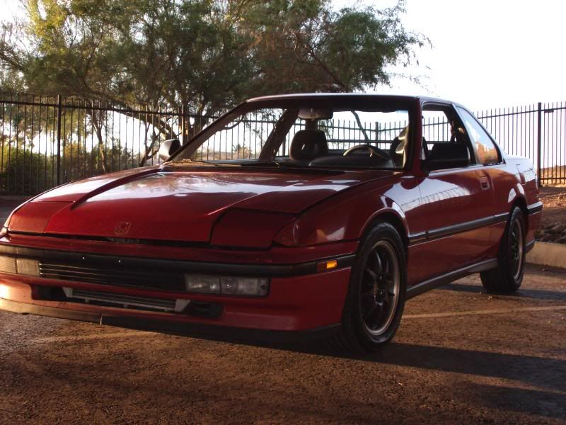

I finally tracked down some old photos of the lude when I first bought it. So here we go. I bought the car in the summer of 1995 in Virginia Beach, Virginia for 10,999.00 with 65k miles. I believe I am the second owner.
My first mod in 1999 was removing the intake piping except the elbow off the throttle body and attatching a filter. Second was 2 1/4" exghuast with an OBX muffler/coffee can. It was a lot of fun to drive but it was monster trucking until I put weapon R coilovers on stock struts and an engalls camber kit. At the time I was living in Louisville Ky.

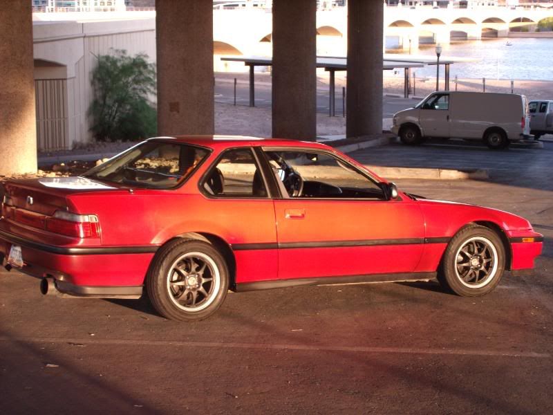

In 2001 I got the SI wheels from my sisters 99 civic SI. I also got the ludespeed water to air intercooled kit from a guy in St. Louis.

Was a great looking car when I saw it a few months back.
Really liked the pics of the 99-00 Civic Si rims on it.

What kind of front lip is that red lip that you had on it a few years ago?
its from a 90 integra. It was about an inch short on both sides. If you look real close you can see it.

Mike I like the Si wheels better too but they were too narrow and I never could get traction under boost.
