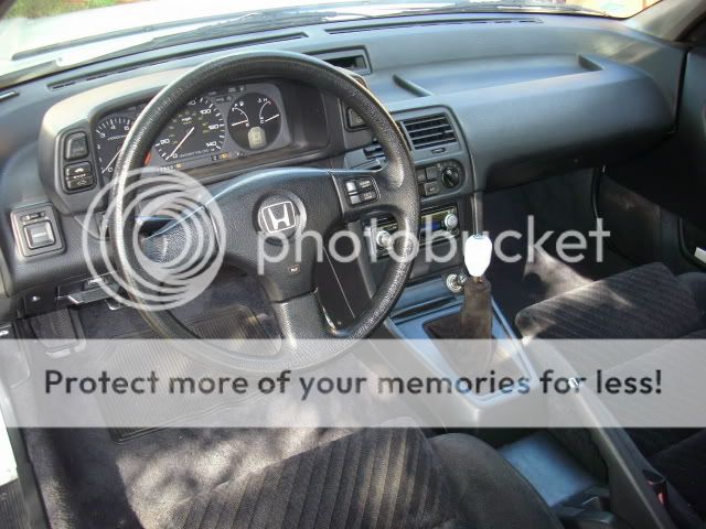

Here are some pics of the 5 speed conversion...
Swapped clusters...
