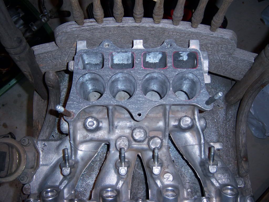

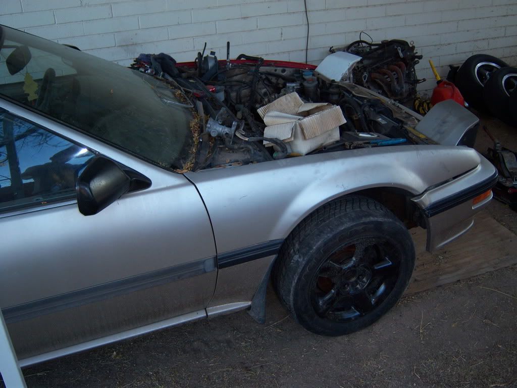

Well i am doing a small build for my new beater. I dont see too many B21's being built or used anymore so i figured id let y'all know what im doing with my beater.
I acquired this gold 88 Prelude SI in a trade and i was actually already building this car for an old roommate. He saw my current DD and really wanted that so we traded with some cash on top of his end.
So i get this thing with a B21 in it. Ive already swapped the tranny to a D2j5 with a new stock clutch. That shit will be coming out very soon!
So i take a spare B20a head i pulled off one of my extra motors and decide to use that on it to boost the compression on it a bit.
I get a little shaved off the head and get the valve seats checked to make sure they seal and all that good shit. Seals are good so no need to do a full valve job.
I then get the head clean the shit out of it and ive ported and polished the intake and exhaust ports very nicely. I spent 8 hours in the head alone. Its of course port matched as well. I want to squeeze every ounce of power i can out of this beater. Now im working on finishing the intake manifold to be perfectly matched to this head.
Im halfway done then i'll get it all mounted up.
I will of course get pics later today for you guys.
I hope this thing does decent for the time ive put into it or im just going to boost another B21!

intake matching
Just a little tip to get the best flow where your intake ports are on the outside instead of trying to match perfectly to the inlet manifold which is nigh on impossible without cutting it up and welding it back on, just open up the edges on teh inlet ports so that they make a nice bell mouthed entry, this really helps with flow just my 2 cents as i'm experienced with head work on an extreme budget as well as no budget!! Also just as another cheap mod you know you can use aftermarket inlets and have them machined to 30mm and use them as exhaust valves? Nice mod if you decide to go turbo as it can do with all the extra help getting the gases out quicker to spool the turbo up faster!! Also if you need more fuel in try adjustable fuel pressure regulator and bump up the pressure a little might make things easier FSE do one you can fit easily rather than the B&M which requires a bit of engineering to fit. Have on on my B20A in my 2G lude which just has bolt ons seems to work well only a few psi above normal but just helps keep things in check untill i get Megaquirt on for now. Nice work on the header 2.5" collector worth adding if you can to match the system will gain nice torque figures with that exhaust not that a B21 needs anymore torque lol!! Oh BTW notice the inlet manifold had quite a rough finish should just polish it smooth as because it's before the injectors no need to be rough like if it were carbs, just nice a smooth to get as much speed as possible, then after the injector same roughness as in your pics, you could also put the valves in a lathe and put the same finish on the heads as well worked well on my last engine doing that where i was running a super short runners on the intake. Also one last thing if you can get the seat on the valve matched to the seat in the chambers honda allways have too wide a seat on the valve head and this will disturb flow, easy to see as you'll see coke on the bit that's not seating on teh valve seat and the rest will be shiny if you get that bit cut away and have a back cut put on the valve you'll increase flow significantly. Also reshaping the valve guide and ramp in the inlet port and also the exhaust port and unshrouding the valves and making sure the valve seats are flush with the chamber walls will help too and you can do all this yourself if you have some spare valves and a steady hand!!

Yeah everything is getting a glass smooth polish by hand.
I cant really do anything to the valves now cause the head is sitting on the block now and im just finishing up the intake manifold. BTW porting and polishing an intake manifold is a bitch for a B20a. B21 mani's are much easier!!!!!
I also will use my 62mm ported throttle body.
I already have a B&M but i will probably be getting some form of tuning for this.
I'll get more pix when im done with the polishing.

Discussion Starter · #12 ·
Yeah i forgot about your build. But i may boost this thing if the numbers arent up to par. With all the head work put into it it should flow very well.
