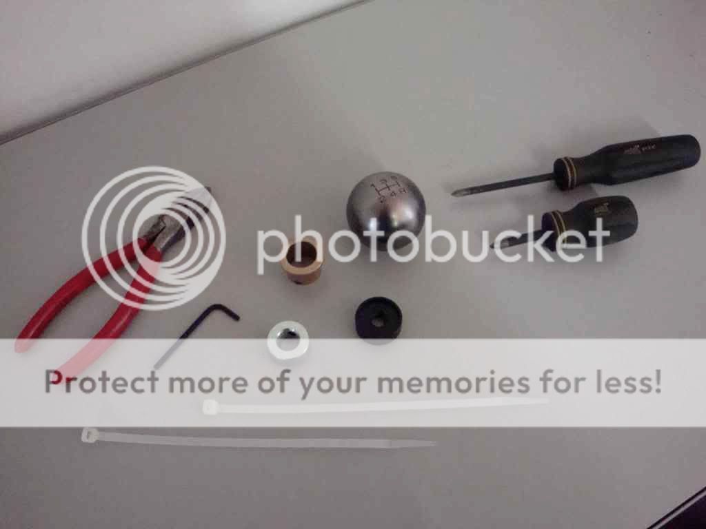

First of all, lets go over the materials your gonna need.
You will need

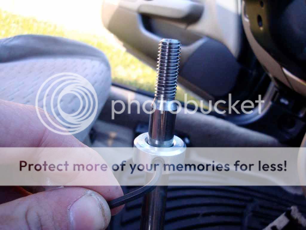

-shift knob of your choice, and its lock nut if it comes with one
-A replacement collar, no one thing is the "right thing" so get creative :D
-something to hold the boot up flush to the knob
-philips head screwdriver
-zip ties
-snips or scissors

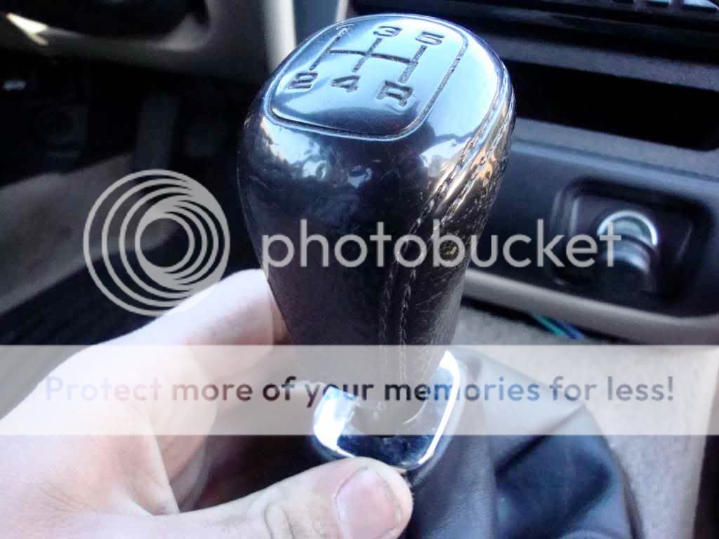

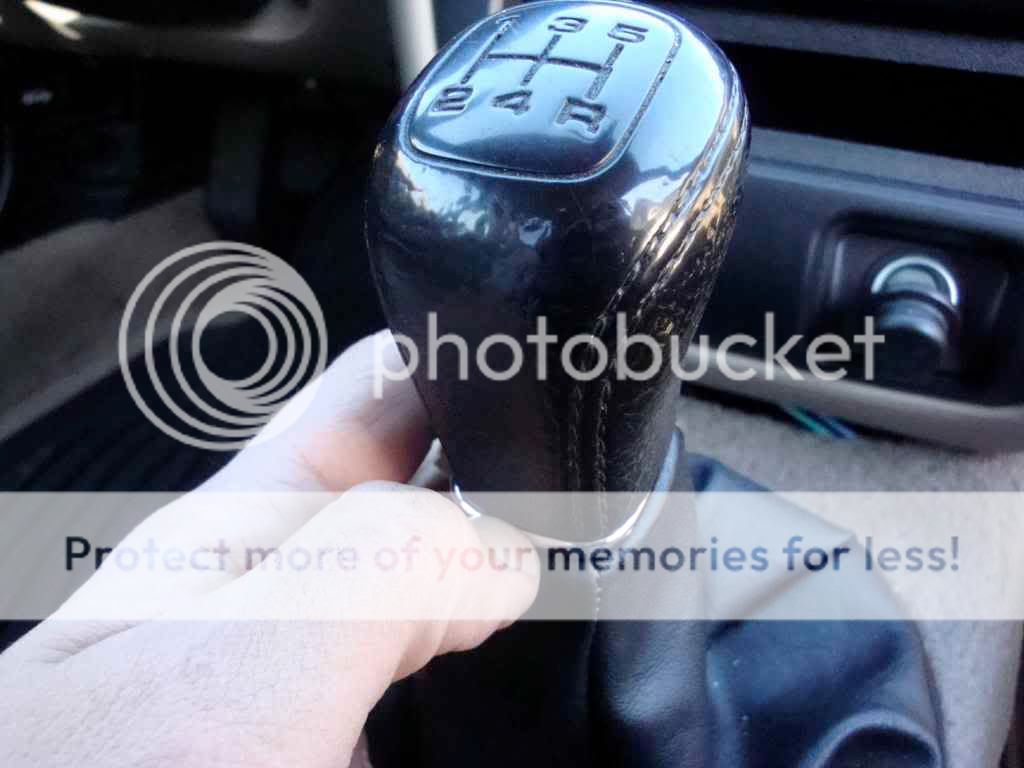

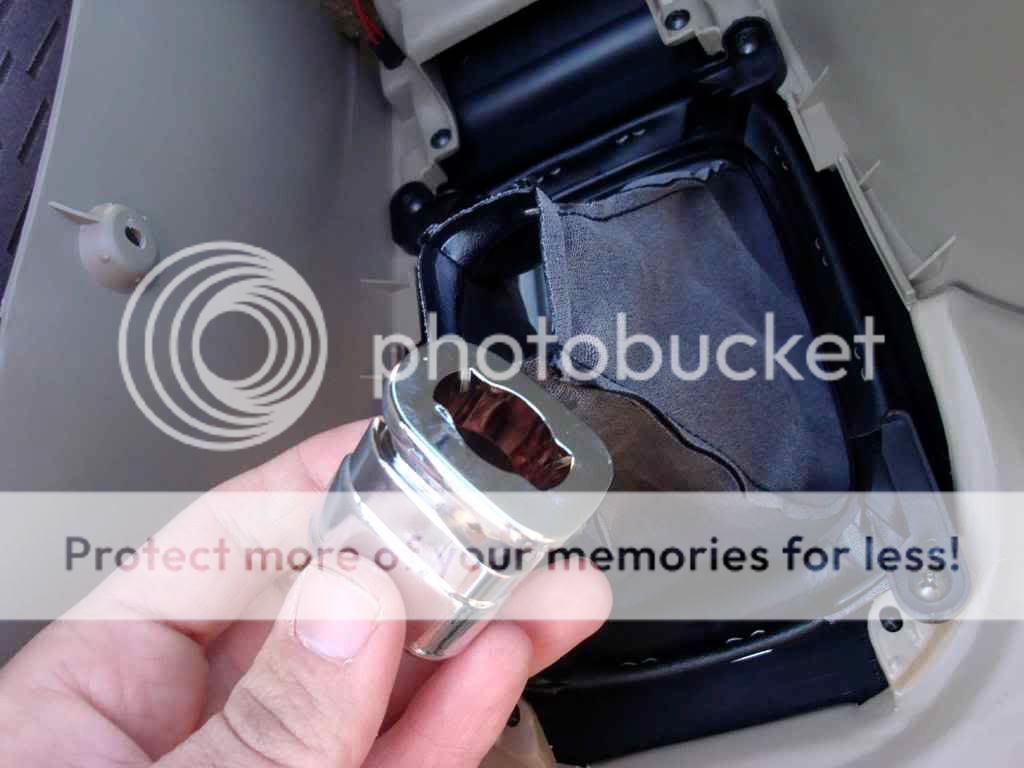

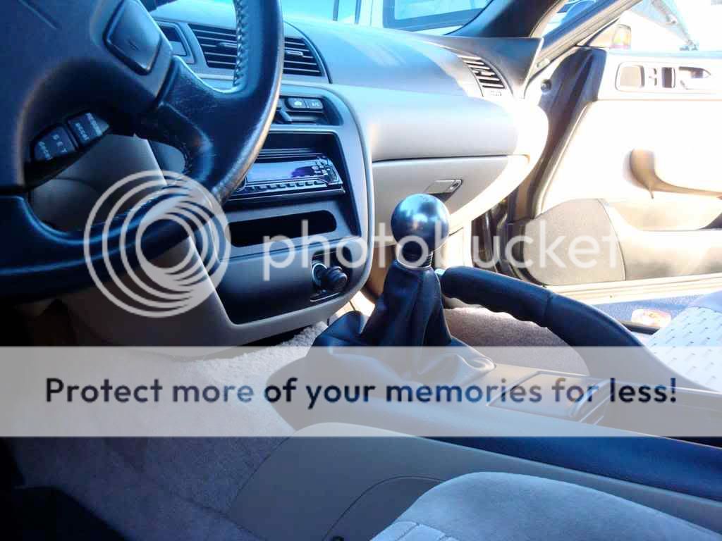

Now lets get started, first, go to look at your stock knob and you will see where the chrome piece meets the knob.
You will need to snap the chrome piece off, just pry underneath of it and it will pop off, and dont worry it wont break even if it feels like it will. You can do this with your fingers or a flat screwdriver.

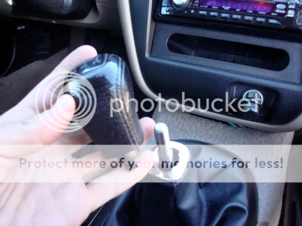

Now you can unscrew your factory shift knob.

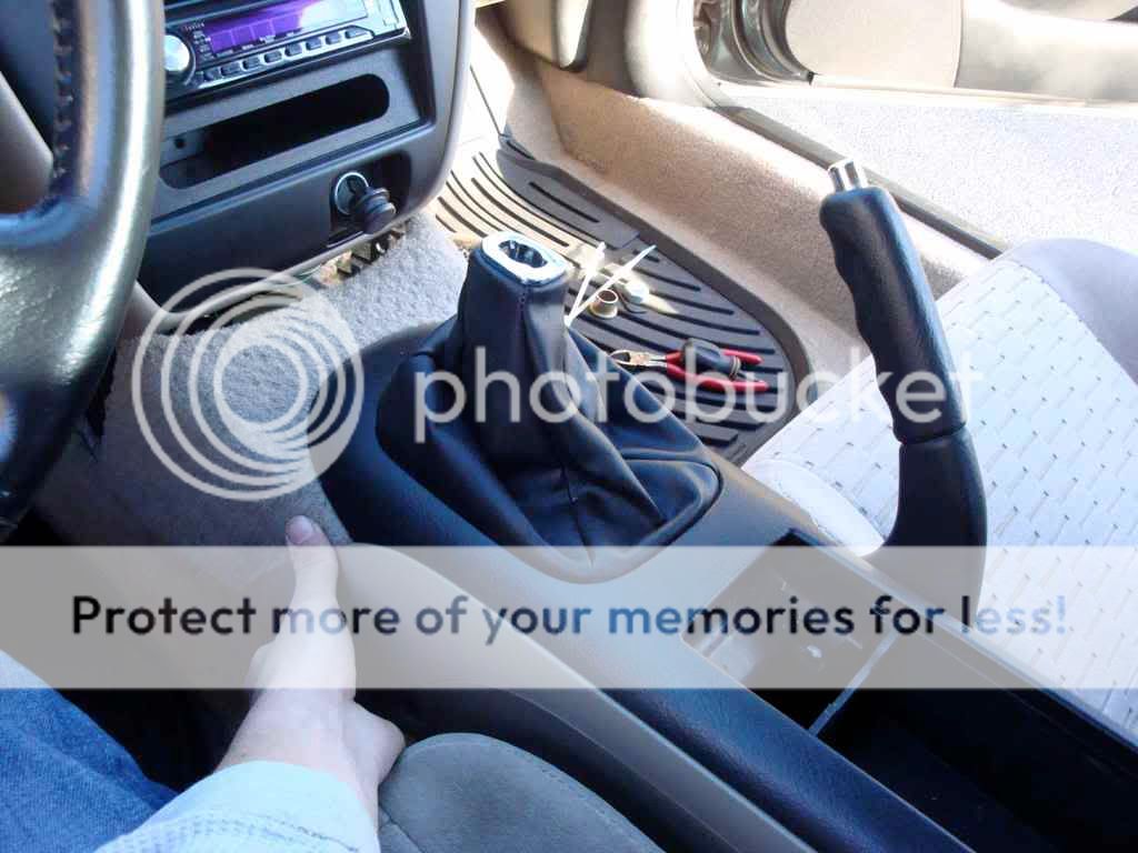

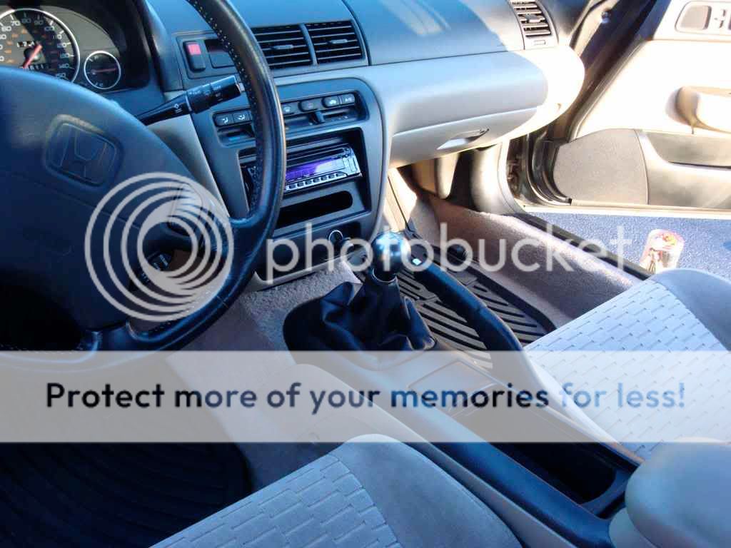

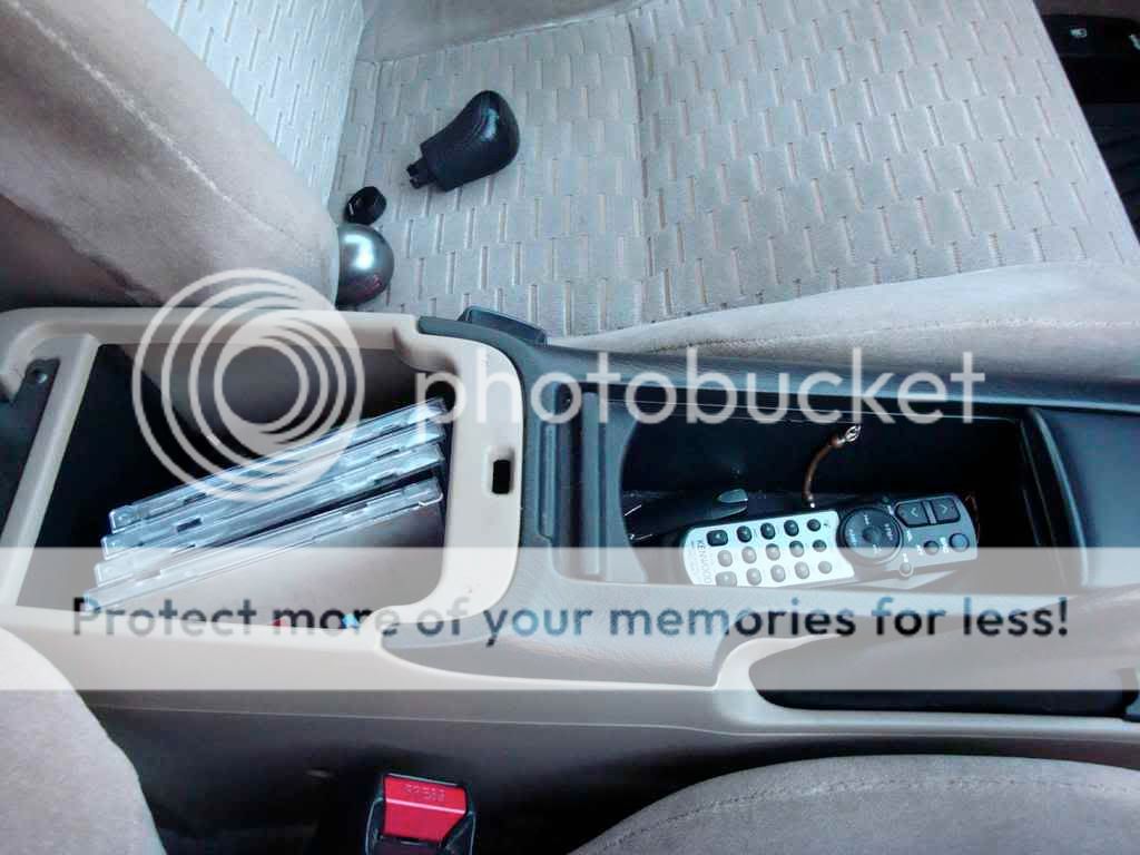

Next you need to get ready to take the center console out, so make sure theres no crap in it.
It should look empty like this.

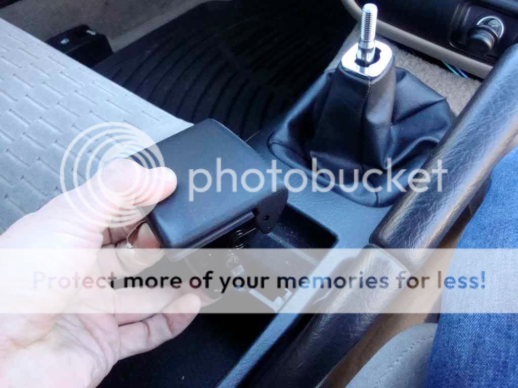

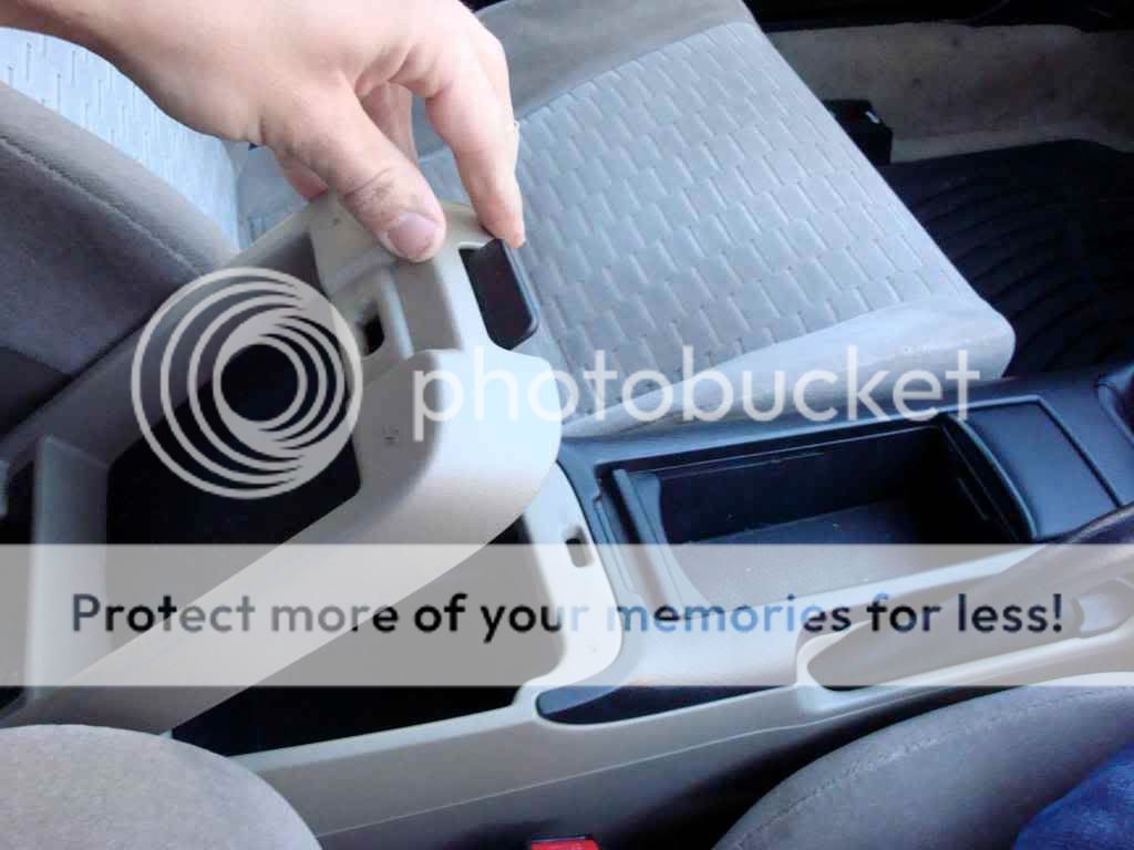

Also snap out your coin holder.

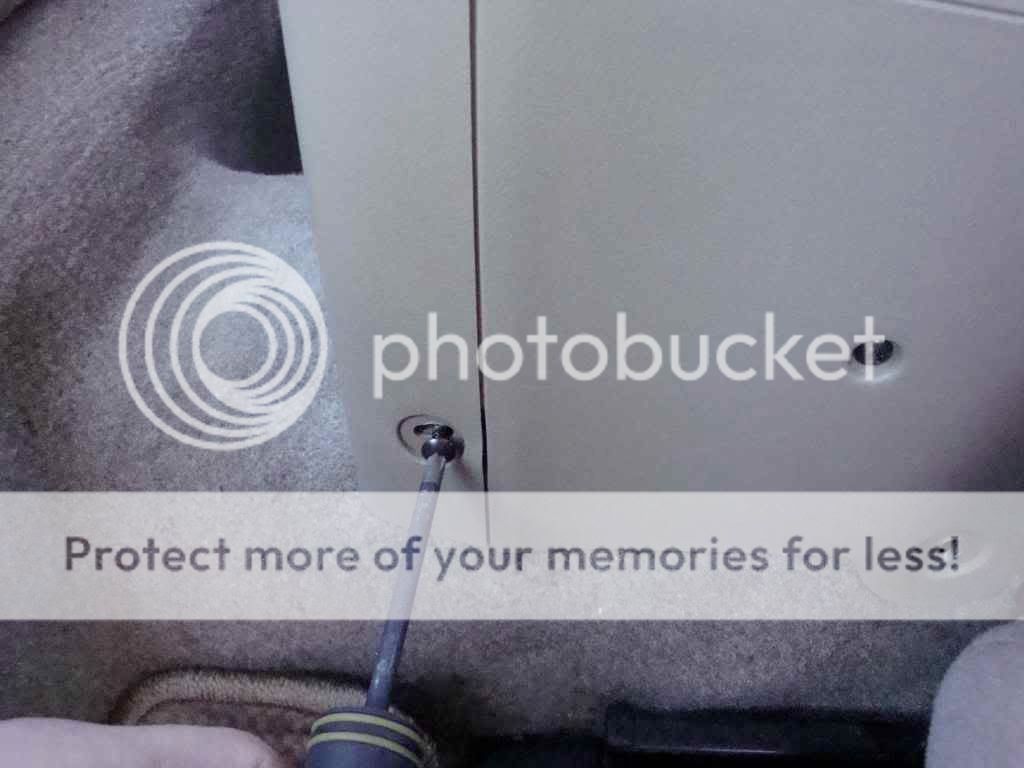

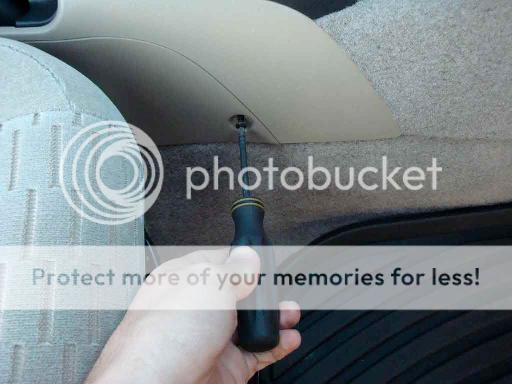

Now you need to take out the screws that hold in the center console. There are 4 per side, the first screw is easily located.
There is also a screw behind a panel up front, so this little panel needs to be popped out. It just pops out by hand
With the panel out of the way you will see the screw that needs to be removed. (Damn you OBD2!!!!!!)

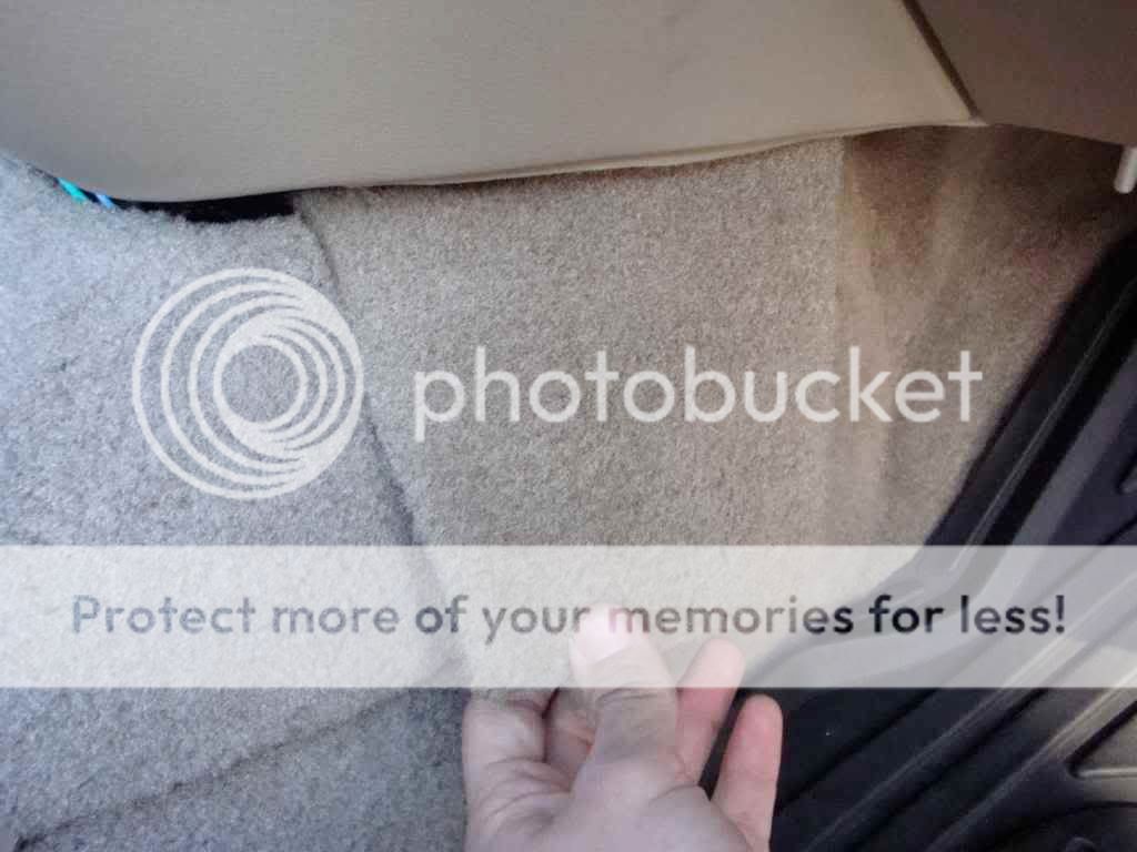

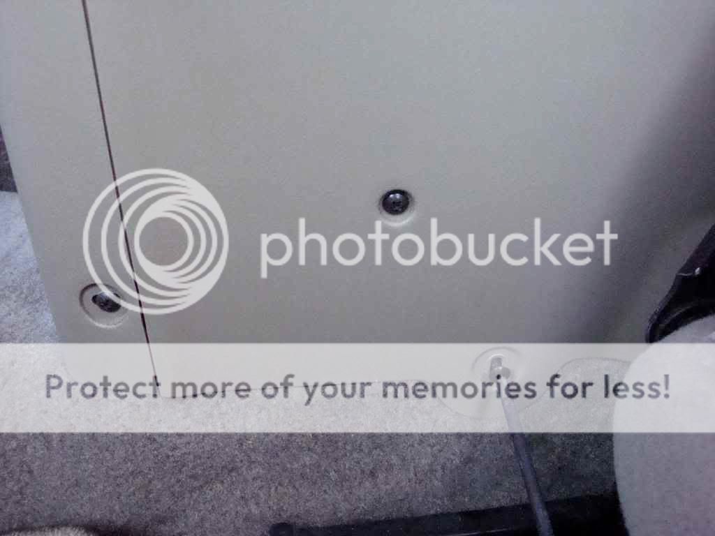

Now put your seat forwards to reveal the other 2 screws. The bottom left and bottom right are the only ones you need to remove, dont take out the top middle screw.

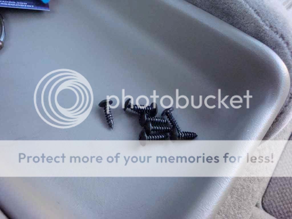

Now repeat the process on the driver's side. When your done you should have 8 screws, keep them together where they wont get lost, i used the sex blocker.

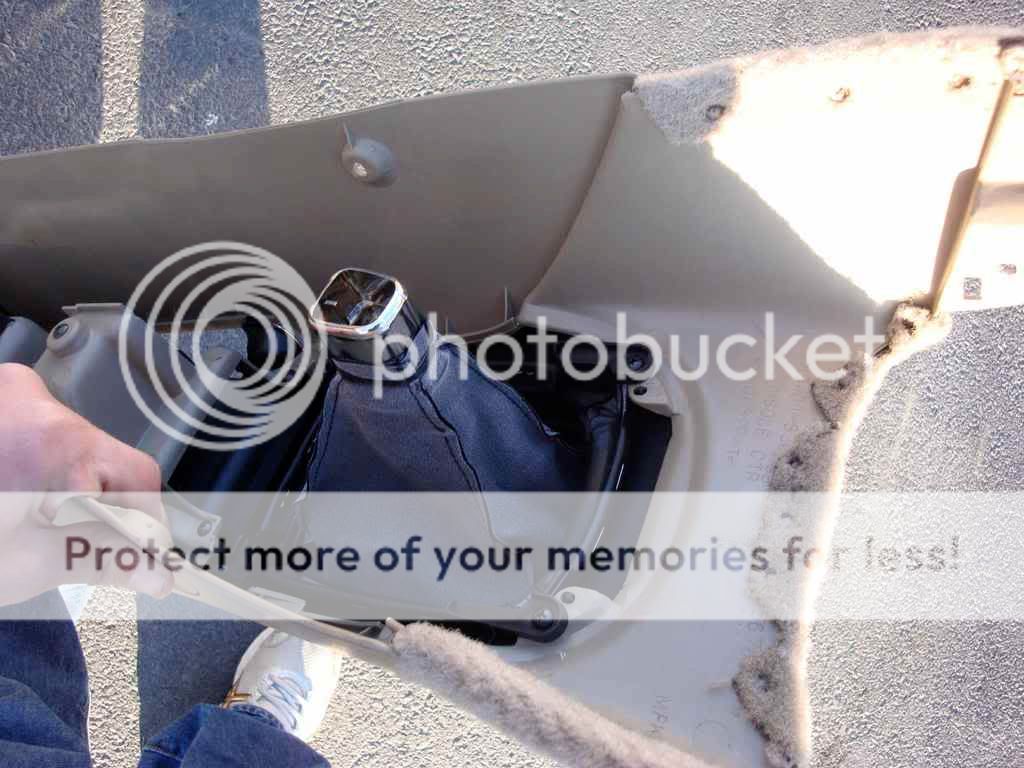

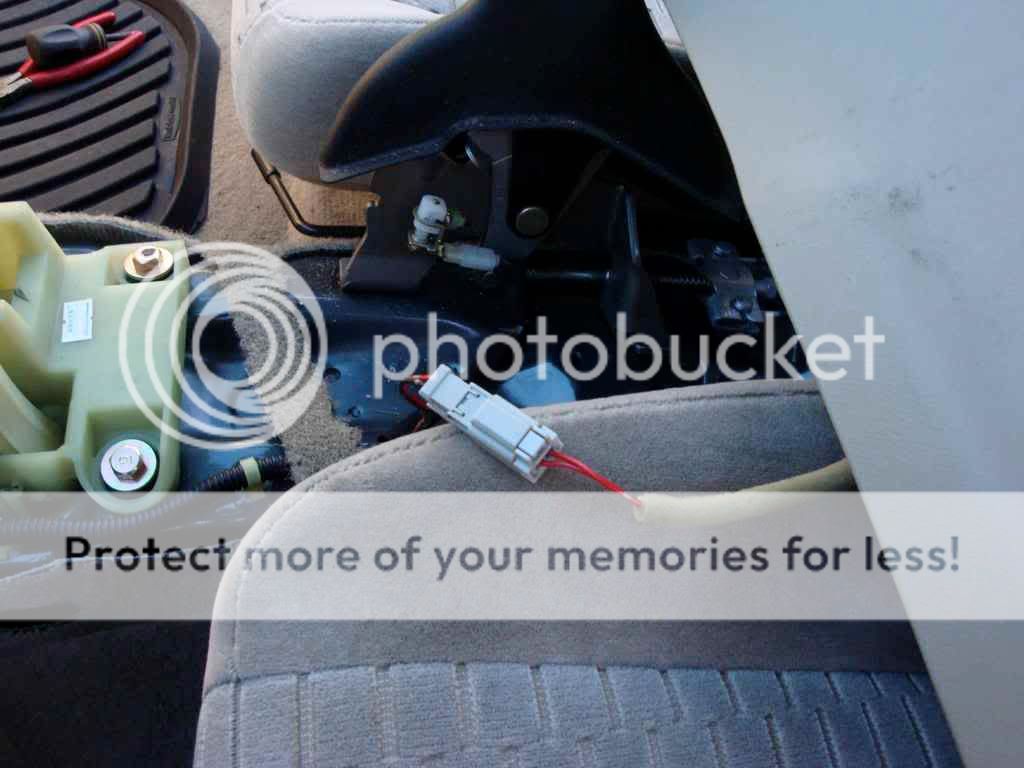

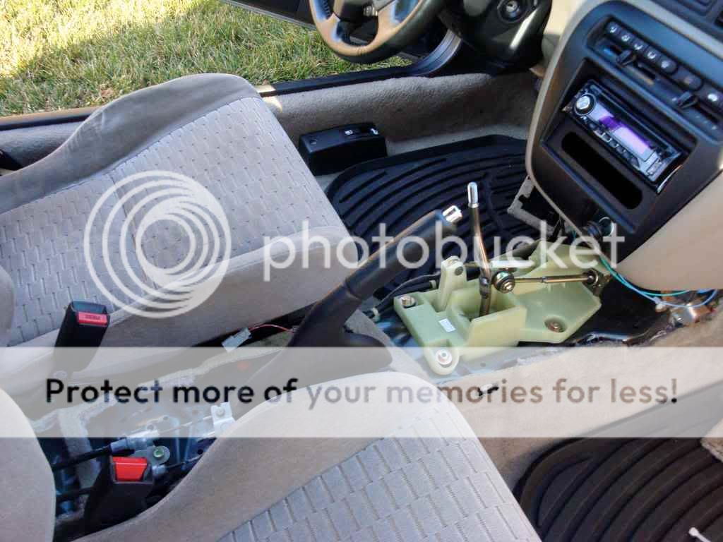

Now you can pull out your center console, its pretty easy to get out, just pull your e-brake up to make it easier. It might require a little wriggling to get it all the way out.

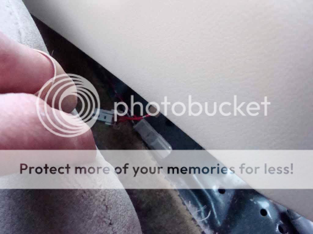

Dont pull too hard, because theres a plug that needs to be undone before it comes all the way out.
LOOK HOW BARE IT IS!!!!

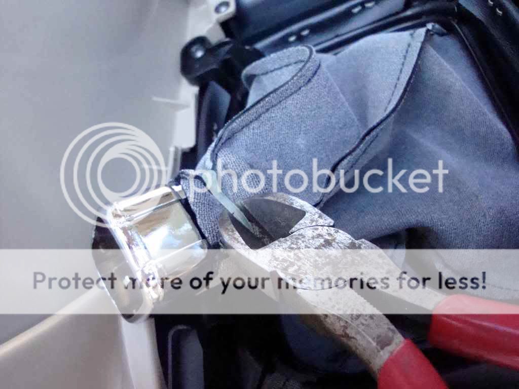

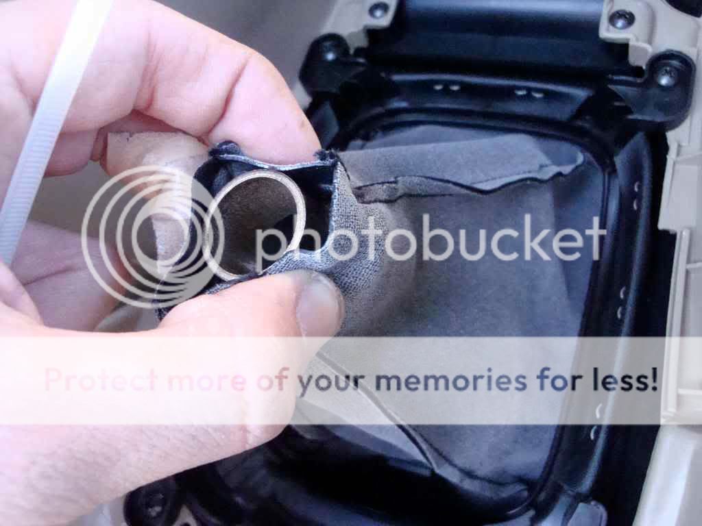

Now flip your shift boot inside to reveal the zip tie that holds the chrome piece.
Now you can snip the zip tie off. Be careful not to snip your boot.
Then you can take out the chrome piece.

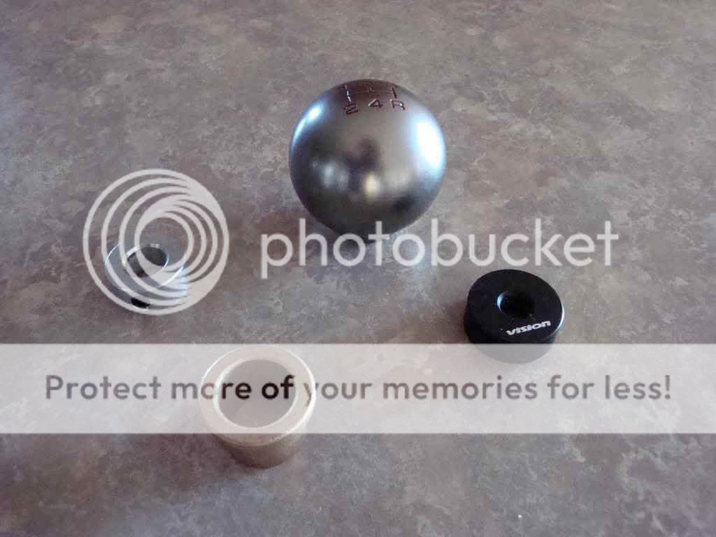

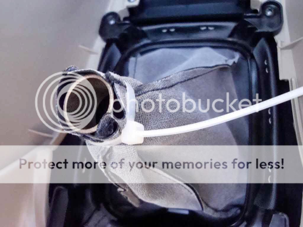

Now slip in the piece your gonna use as your new collar.
Zip tie it on, the smaller zip tie the better, big zip ties have big heads that pushes out the boot and makes it look gay.
Now put on the washer piece to hold up the collar and boot. Dot tighten it too much, because it will probably need to be adjusted

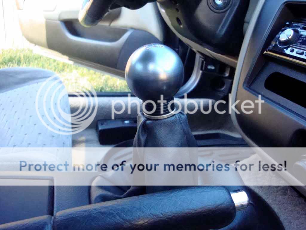

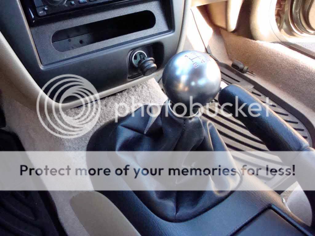

Now you can put the console back on, just check to see if the boot is held to where you want it, if not, adjust the washer piece and tighten it when you get it where you want it. It might take a couple tries to get it just right ;)

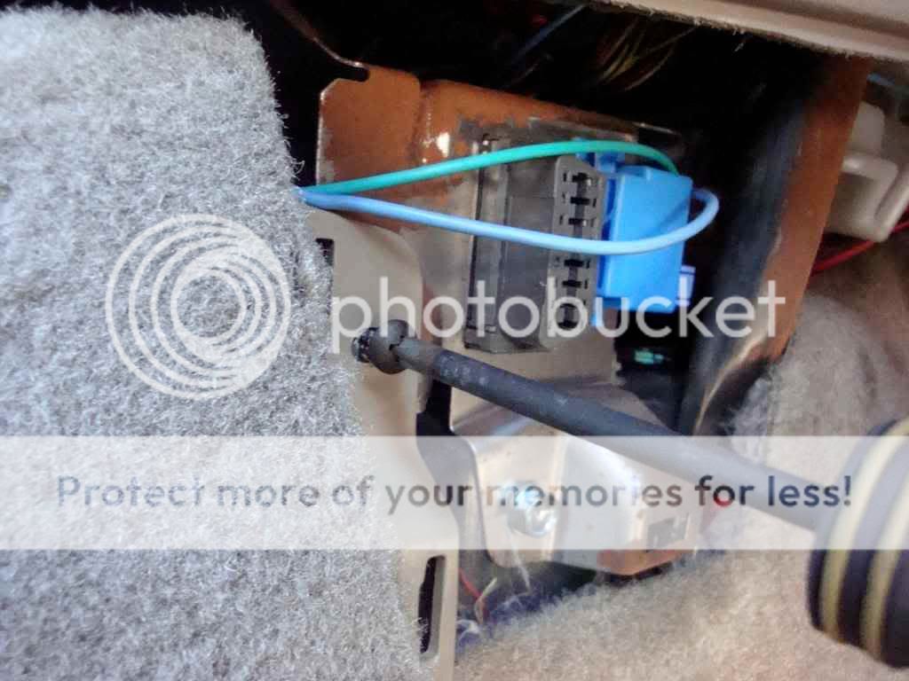

Once you have the boot where you want it put the console back in, it mike take some wriggling, but its simple. Then put in all your screws and put the panels back on. Dont forget to reconnect the red wire.
Now that your done you can put the knob on and bask in its glory :D

Wow that came out really nicely. I need to do something like this on my redline shift boot since it's kinda all over the place and looks kinda bad if I havent just pulled it back up
2,540 Posts
go to ace hardware and get one of those washer things I got. Works great.
I wasn't expecting it to come out as good as it did LOL
Dented
724 Posts
that's a great write up.. and a really surprisingly good outcome. Usually diy's don't look like you bought the finished product.
