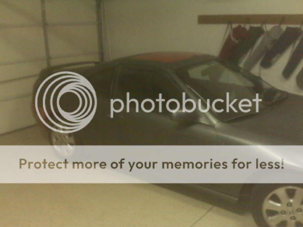

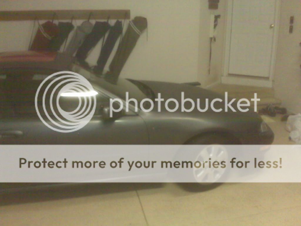

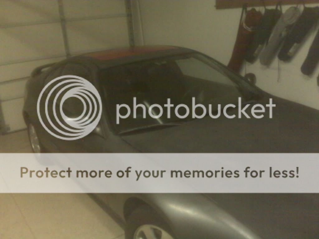

So I've been roamin around PP a while now. Mostly because a friend of mine (NocalNative89) has had a prelude for years. Ive helped him for years and hes taught me alot. But a few months ago, he picked up a 93 VTEC as a parts / project car. I had never had a car, but partly due to him they're a huge passion / hobby of mine now. So naturally, I was ready to help him out. The car needed a master cylinder, body work, paint, a ton of interior parts, bumper, and a bunch of stuff I know im forgetting. But it ran well. And since I helped him out, he cut me a deal. So its mine now and i'm soo excited! Here it is: (better pics after fresh milano red paint :bigsmile:)
