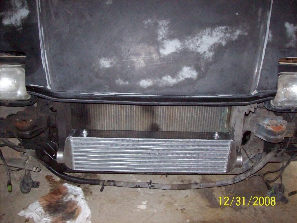

I have the intercooler where I want it, but I need to cut the bumper a little so it can go back on.

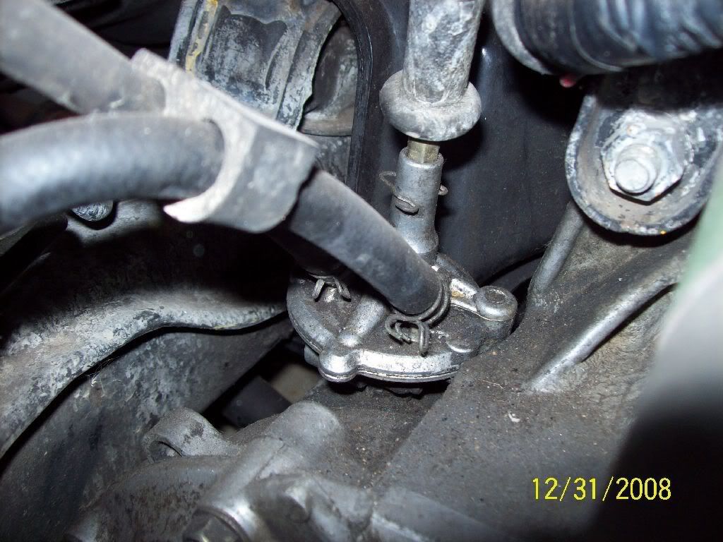

Does anyone know why I have power steering lines running to this thing on my transmission. If so, what is the purpose of the part? I can"t tell by looking at it. Why would they need power steering connected to the speedometer cable?

That thing by the speedo cable is a valve for the speed sensitive steering. It increases the power steering assist at low speeds to make maneuvering easier.

Cool. Thanks.
