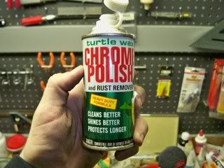

-Chrome/metal polish

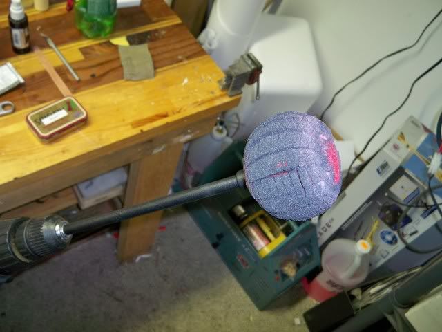

Step 1:
Make sure polish ball is firmly tightend to the extension and make sure the extension is firmly fastened to the drill

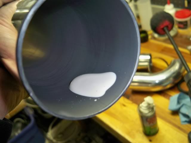

Put a good amount of polish inside pipeing as shown below probably want a little more than I have.
Step 3:
Insert polish ball into pipeing and make a in and out and circular motion from both sides until your satisfied with your work.

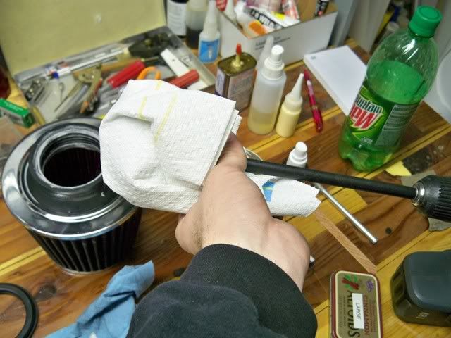

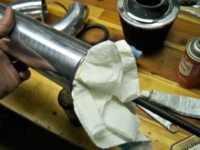

Grab 2 sections of paper towel and put them over the polish ball as shown below:
Step 5:
Insert the ball with paper towels around it carfully and make sure not to rip the paper towel,
Step 6:
Do the same motions as step 3 ( when you were polishing the pipeing ) I recomend doing this 3-4 times with a differnt paper towel each time
to ensure you get all the polish out..
