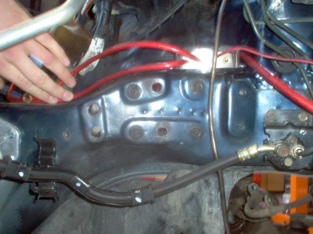

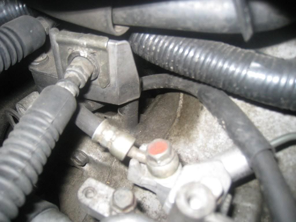

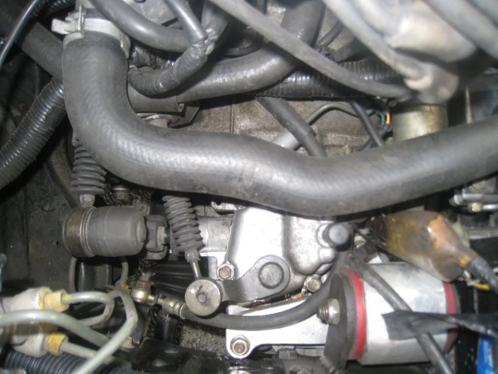

i hope these pictures do the explanation if not ask away.....(note: you must take off the heat shield that comes with our stock slave cylinder hose to do this).
from passanger side routed in between tranny mount
around tranny and under tranny cable bracket to avoid/stop the shifting arms from hitting the hose
here you can see no obstruction with the shifting arms

this pics shows the bracket that needs to come off
