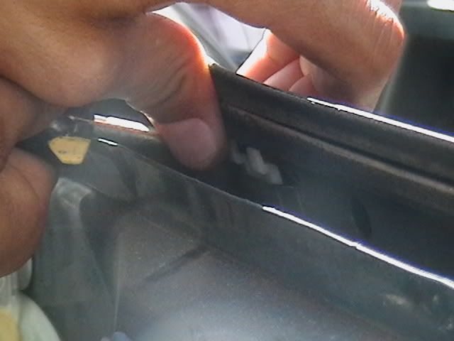

Now for the tricky part. Put the flathead screw driver on the bottom edge of the molding, near the white clip. Start from the clip nearest to the mirror.
Push down on the screwdriver, so that it pushes the molding up. Once its up a bit, reposition the screw driver so that you have better grip on the molding.
You’ll hear a loud POP and the clip and molding will come up, but still will not stay there. Time to move onto the 2nd clip. Do the same thing.
By the 3rd clip, you should be able to lift it up with your hands. Pull it up, making sure that the clips come out smooth.
