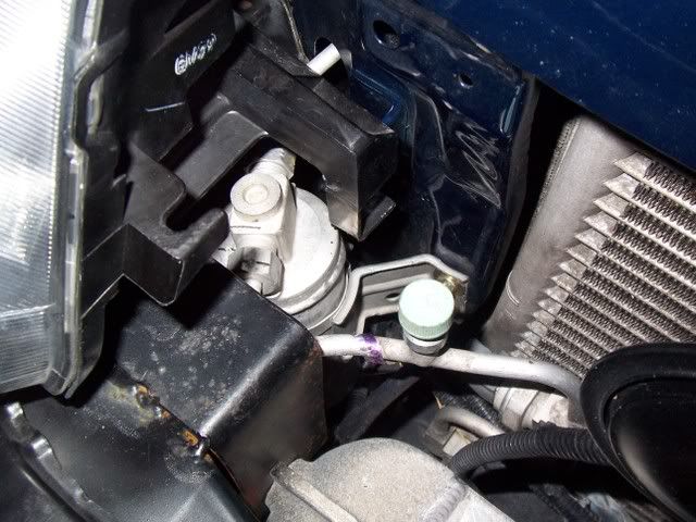

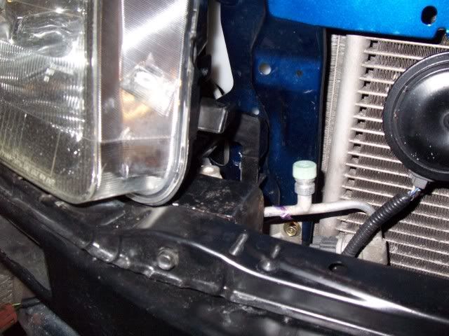

oh yeah, here's how the first one came out
started with 320 grit wetsand then 800, 1000, 2000, then plasticx and then a layer of wax
here's the closest before pics i have
once i get this other one off i'll take a pic of the two together to show the difference
Undo the A/C dryer, move it down, then you'll be able to get a little rachet in there
5,085 Posts
I believe I did mine just using some extensions. It's been sometime now since I took them out though.
Mike (H4L)
215 Posts
try a 10mm ratcheting wrench thats what i used on mine
324 Posts
This little tool saved my life.
