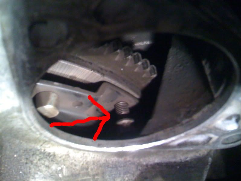

I've got a 98 base 5 speed with a bad starter. i bought a replacement and in the process of swapping them, i came across this loose bolt holding some sort of plate to my flywheel.
if i could turn the flywheel back just a bit, i could probably tighten it. any suggestions?

Not good! Its an inverted torx, cant recall which size though. I doubt you will be able to get to it through the starter hole, but its worth a try. Make sure you put some red loctite on there! and check all the other ones. Rotate the engine via the crank bolt counterclockwise. GL

Thats VERY VERYVERY Bad Brahh. Trust me. drop the transmission.

its a 10mm 12-point... I had all my bolts come loose on me before. This time round it has loctite and torqued slightly more than factory spec.
oops, I thought they were inverted torx, sorry for the misinformation OP, thx for the clarification deafy
Symptoms? probably not, if you are hard on the clutch you may get a bit of warping on the pressure plate causing some clutch chatter. If it falls out you will sure as hell know!

good news. I found a way to turn the flywheel. Stick a flat head screw driver into the teeth on the flywheel and use the edge of the starter hole to pry it backwards. Just gotta be gental. Also the bolt is accessable through the hole. So far 2 have been loose. They've been marked as I go. I'll have to go get the proper socket tomorrow.

Good, be sure your turning the engine the right way, if you go the wrong way you will loosen the tbelt
Edit: pull the plugs it will make it a whole lot easier to turn.

shit, i was turning it counterclockwise
there were 3 bolts total that were loose BTW

that is really really bad. if i were you i'd dropped the transmission, resurface the flywheel, and get a new clutch kit....depending on how long you've been driving with that loose pressure plate bolt... 10mm 12point. good luck.
