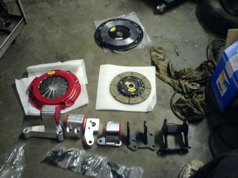

Mounts, 12LBS fly wheel. Clutch.

I must say this swap was no where near as hard as i thought. and i'm glad i had the advantage of a hoist :D. more pics to come of what my ideas are for the skid plate and what not. I also chose to keep PS as this was my daily driver and I wanted to keep the drive comfort there. Pics to come for everything. all in time :)
