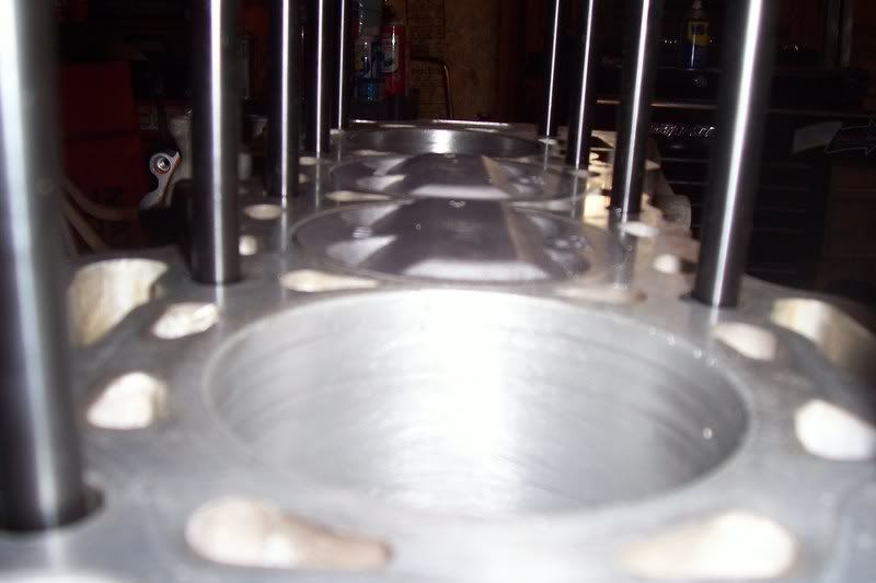

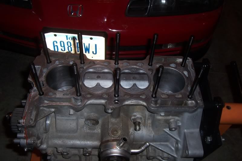

the whole botom end is balanced and has fresh bearings

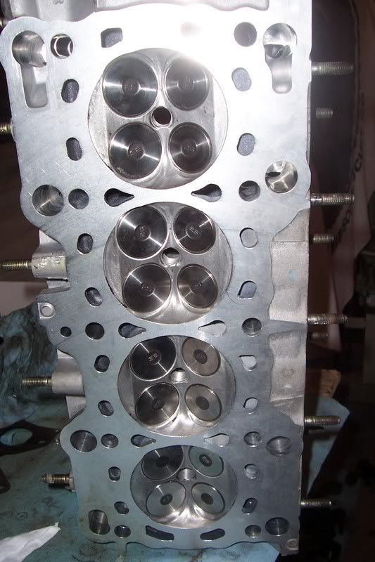

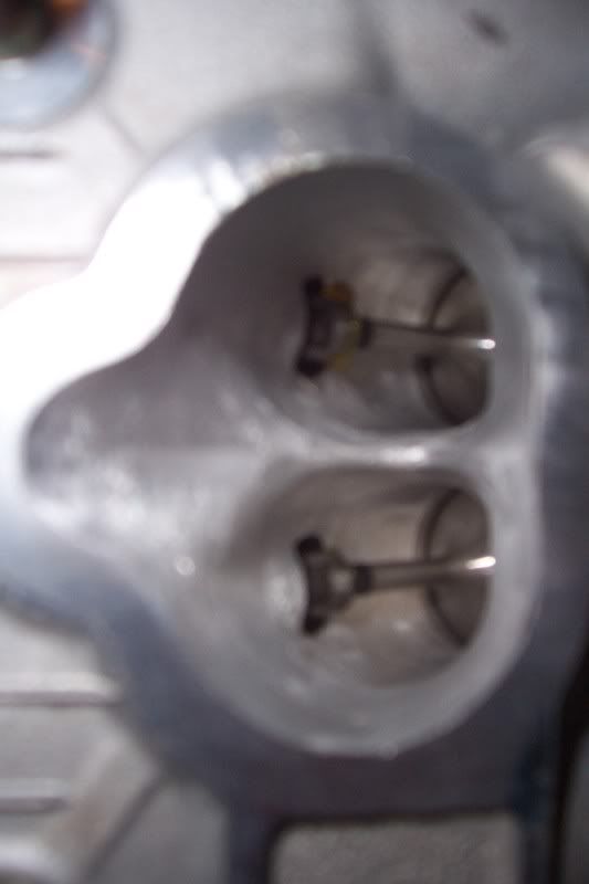

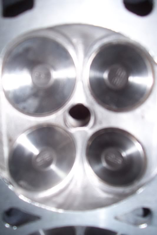

an who did the port work? hard to tell from the pictures but it looks like someone just scratched it up with a paper roll.
and you probably already know my feelings about crome so i'll just leave that be.
the afc is for looks only,,,,,,i have had that thing for ever
the shop that did the port work is mostly into circle track racing
and v-8 drag raceing..... the total cost for head work labor only was 450bucks in the state of iowa....... the exhaust ports are really smooth but the intake has a little bit of ruffness to it! im not really sure if it was good quality work or not! time will tell i geuss lol
