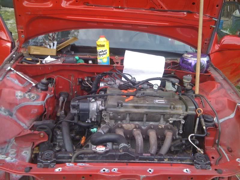

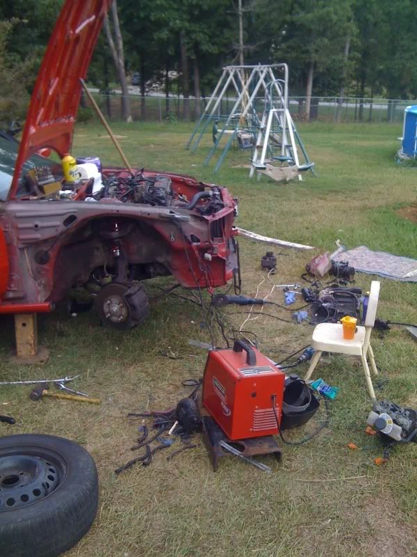

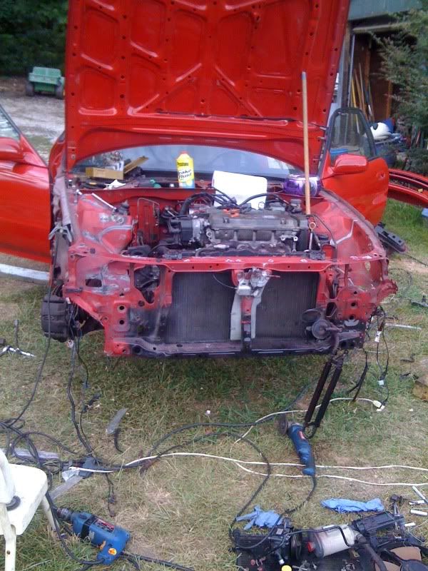

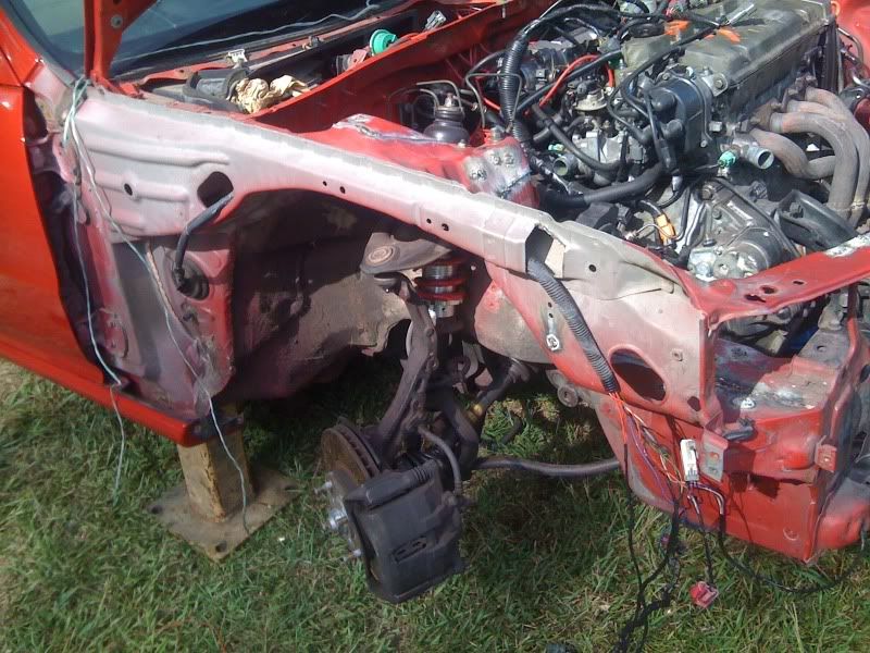

So I decited to keep my lude since I've had it for so long, so since im keeping it I gotta rebuild it the way i want it, so i decited to rewire, shave and repaint the engine bay, also remove ac, ps, and abs. I hope i finish the car before i get my license back, which is in March. So i started the build last week. Here are pics from last week. and i will try to update this thread as soon as possible.
Before I started:
Started taking apart
that where i got so far. About to go out and start working. Will post pics at end of day

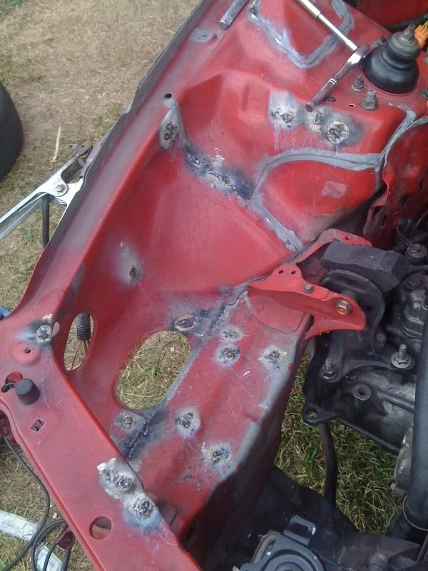

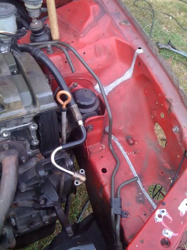

Shaving down the body/frame welds in the bay? Would that be safe? Haven't looked much into it but have thought bout it, one friend just said wouldn't recommend but just his opinion.

Plenty of people have shaved bays. Filler might crack if you put a lot on and have stiff suspension, but the welds are going to be stronger than the seam sealer they use from the factory, so you're safe there.

thanks for the comments guys, and yeah i took out SRS ,ac and heat, and i'm gonna try to use just a little bondo not a lot, its mostly going to be welding

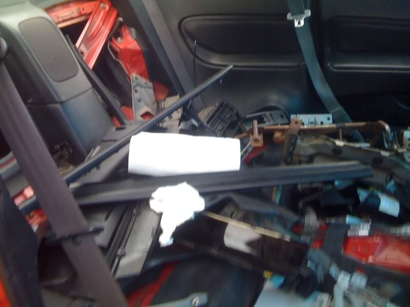

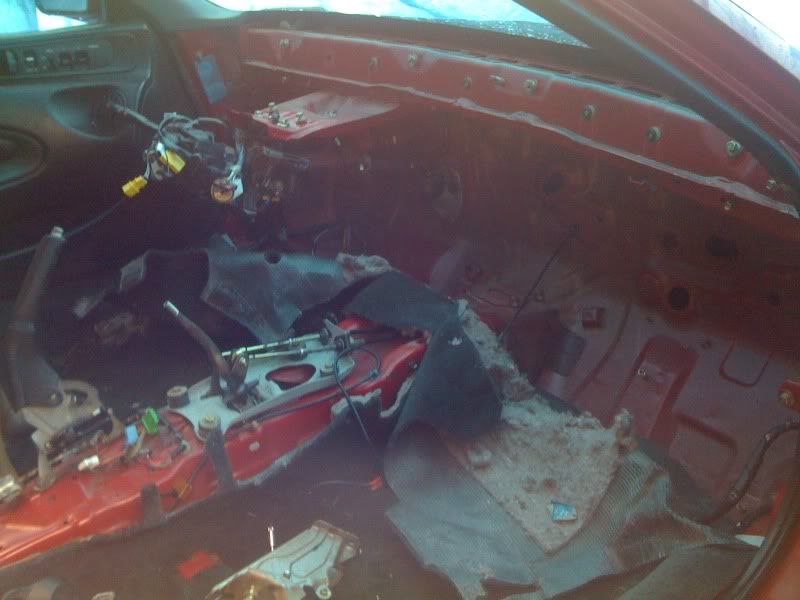

Update 02: didnt get much done today cuz i was helping my dad change the right wheel bearing on my moms Odyssey, so all i got done was take all the interior to my garage and take the carpet out, and i also took out the ABS computer thing out, here are pics

Ok think I'm a little confused. You've shaved the "seam sealer" then welding over and shaving down again? Huh?
And usually when I see or hear shaving a bay its just filling holes.

oh yeah the the trike is my bros lol
^ I scrapped off the seam sealer and am going to weld the cracks then grind them down and if the surface is uneven i'll add some bondo, same with holes i dont need, i'm gonna weld them shut then grind down the welds and use bondo if the surface is uneven
ok see I didn't see mention of you actually welding anywhere at first so I was assuming you weren't and got kinda confused for a sec lol. makes sense now.
