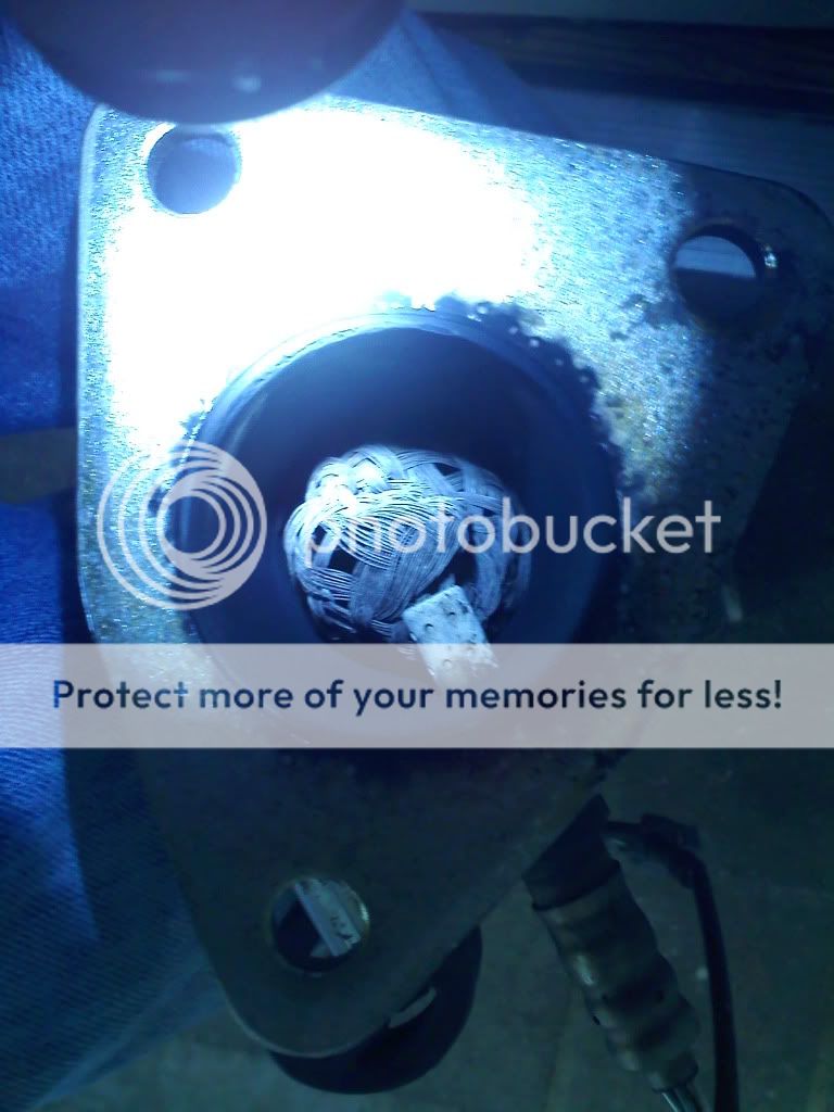

About 6 weeks ago, i noticed a badass leak. Went to check it out, and the gaskets and bolts were fine. And i realized it was leaking from the flex pipe. I also noticed that the car was running ALOT slower. It went from consistent 15.2s to consistent 15.6s and dropped 2 mph. But i thought it was just in my head. I figured id leave it alone until i got a new header, but i cant afford one, and the rattle and leak was pissing me off to no end. So i caved today and swapped it out for my stock one, and holy hell. When i took the damn thing off, the flex pipe was IMPLODED, COMPLETELY BLOCKING the header pipe. The flow was restricted by almost 100% I honestly have no idea how the car was running.
No, i didnt tamper with this header at all, this is how it looked when i took it off. and its worse than it looks in the picture s well. regardless, imagine what this does to your horsepower

no wonder she was running slow. she was hitting 15.5 on 2.2 60 foot times, i shoulda known something was up
