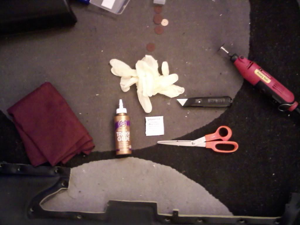

here is what you will need:
your fabric of choice
scissor to cut fabric
tacky fabric glue
dremel/dremel type rotary tool or utility knife
pliers (not in pic)
rubber gloves (to spread the glue)
plastic bond/weld epoxy (not shown $1.97 at walmart)

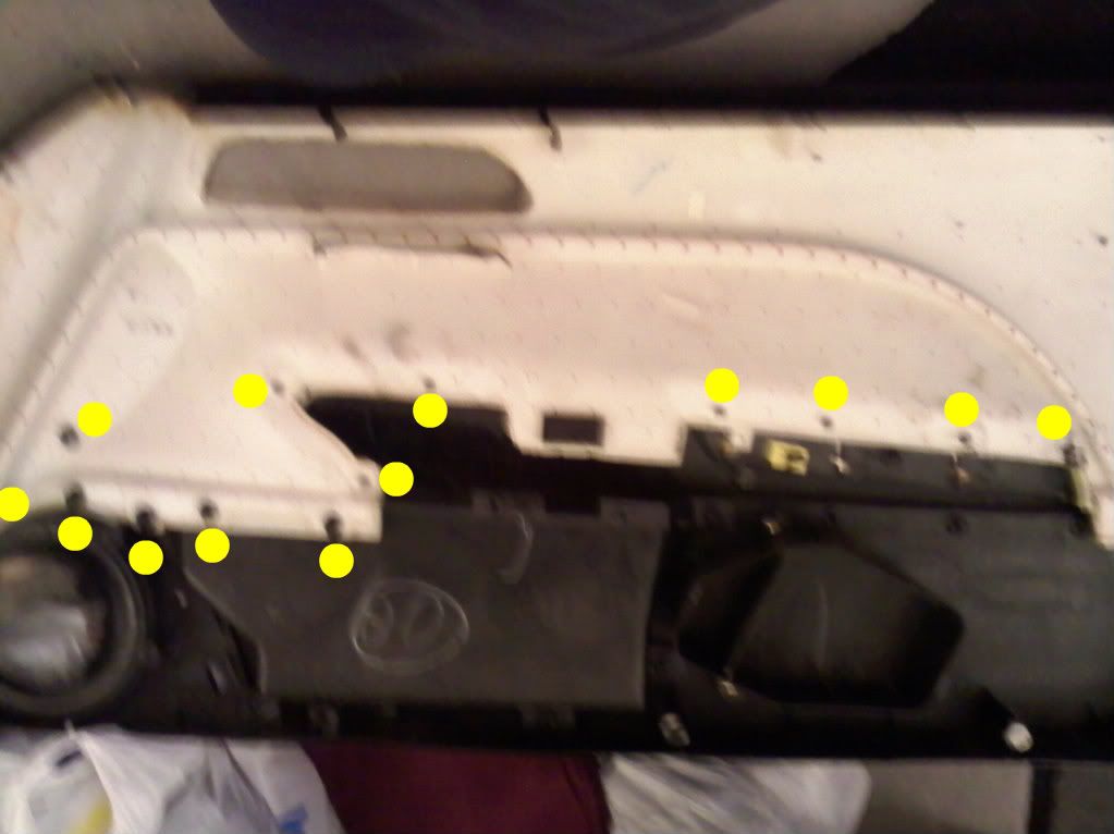

step 2: cut tabs along rear panel
the yellow dots are the tab locations. there may be others that you'll find along the way. for these you should use your utility knife NOT the dremel and just cut away. you will later use plastic epoxy to reattach everything.

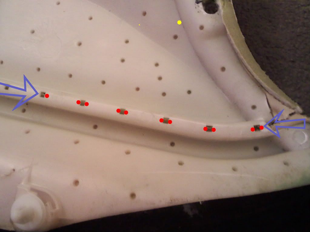

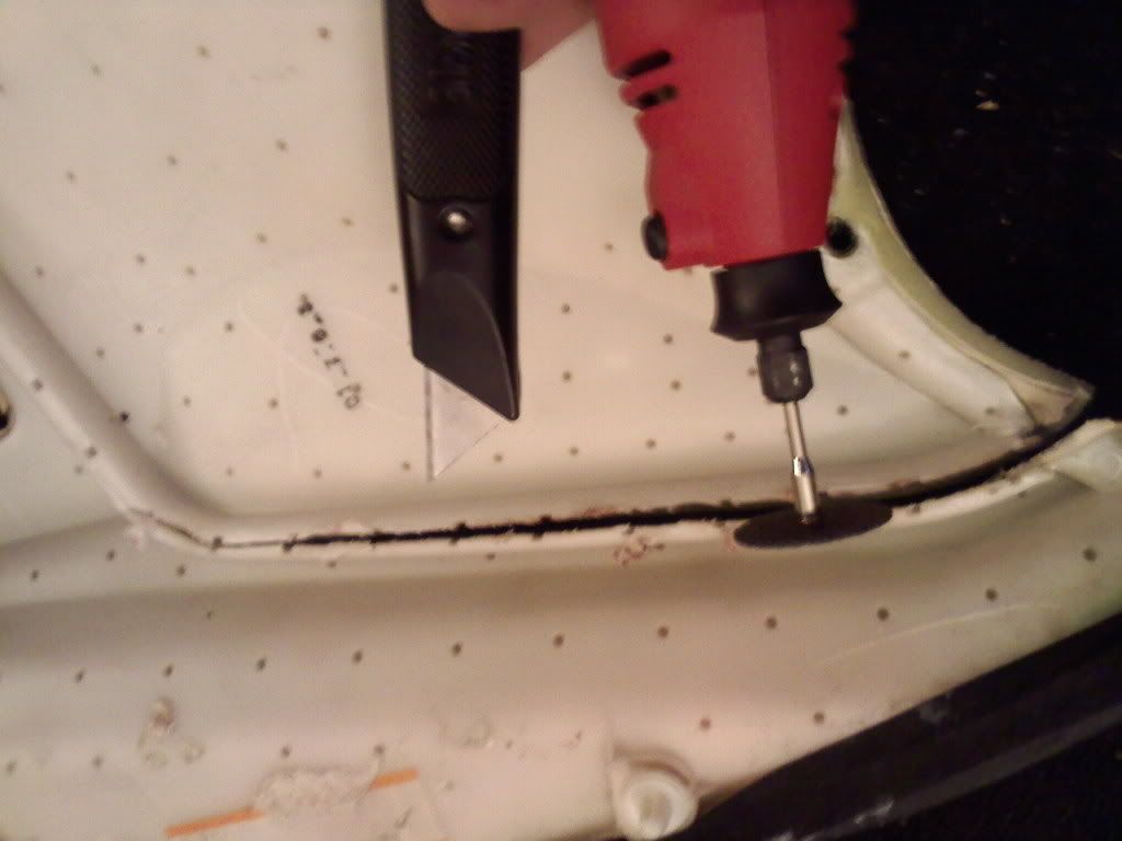

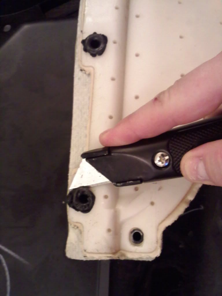

now to separate the 2 portions completely you will need to use either your utility knife if you don't have a dremel or use the dremel. this took less than 1 min using the dremel w/ cutting wheel. you will cut from one end to the other cutting between eact hole (represented by the red dots)
when you get to this point you will need to use the utility knife because you might not be able to use the dremel at the angle you will need to cut.

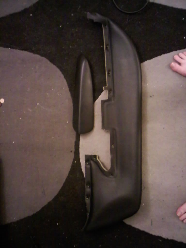

now separate the two piece.

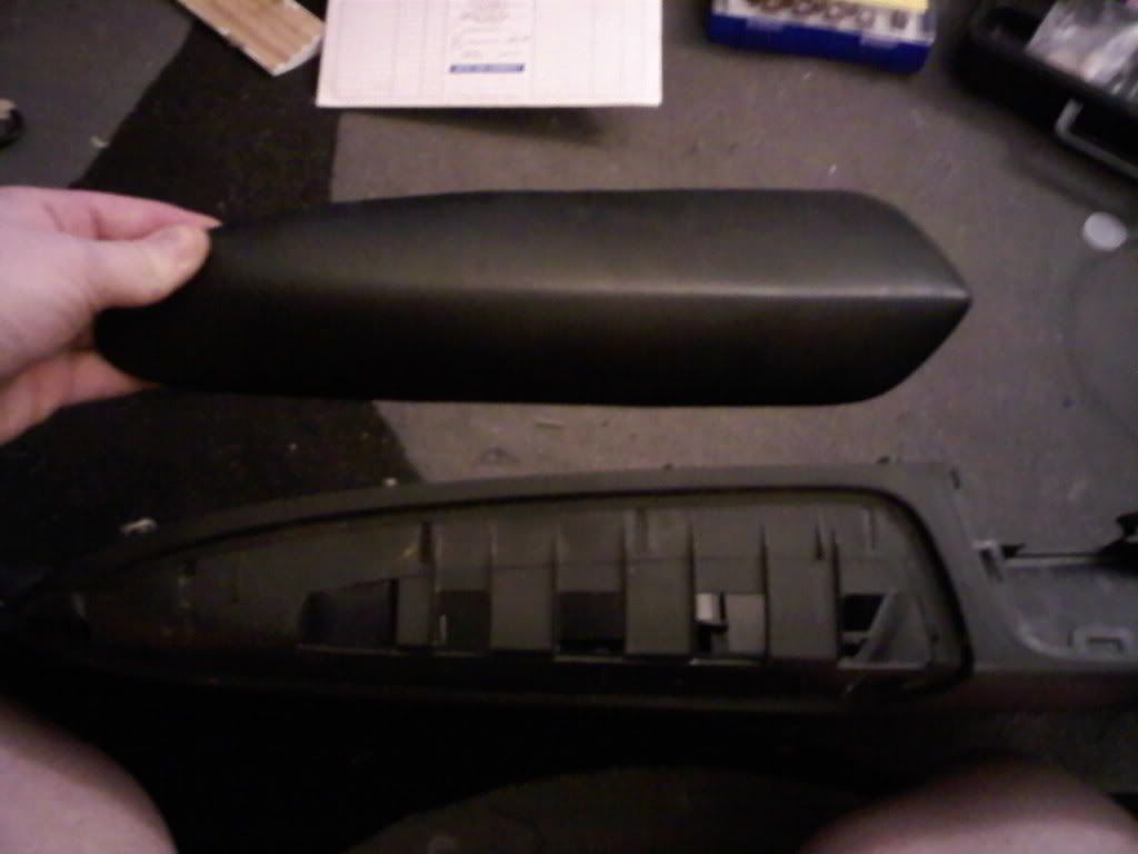

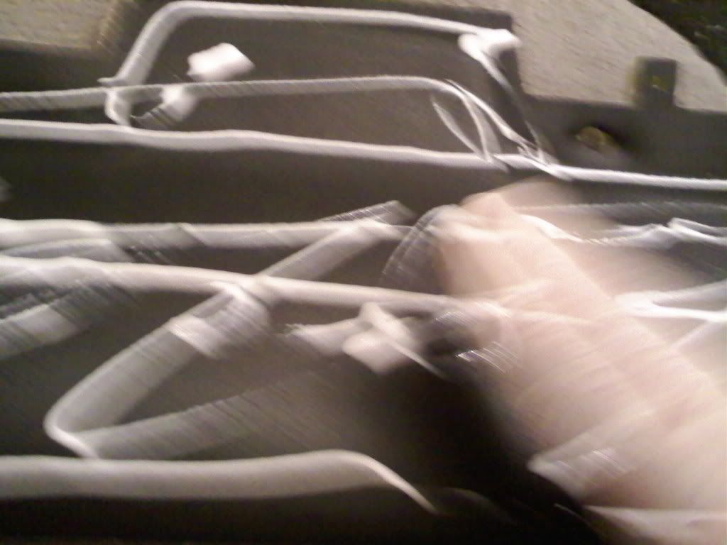

now that you've separated the 2 portions take the part w/ the arm rest and flip it over.
underneath you will find several tabs that hold the arm rest to the door pane. use your pliers here and just bend them so that they point straight out.
sorry for the shytty pics of the under side of the arm rest. there are 8 tabs that you'll need to bend.
once all the tabs are bent to face straight out you can pull the arm rest off the door panel. you should end up w/ this:
now you have both pieces detached that will be covered in suede (or the fabric of your choice)

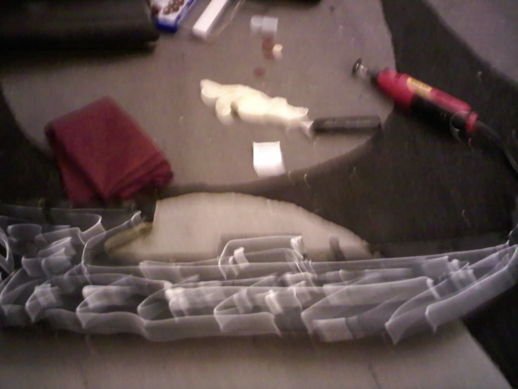

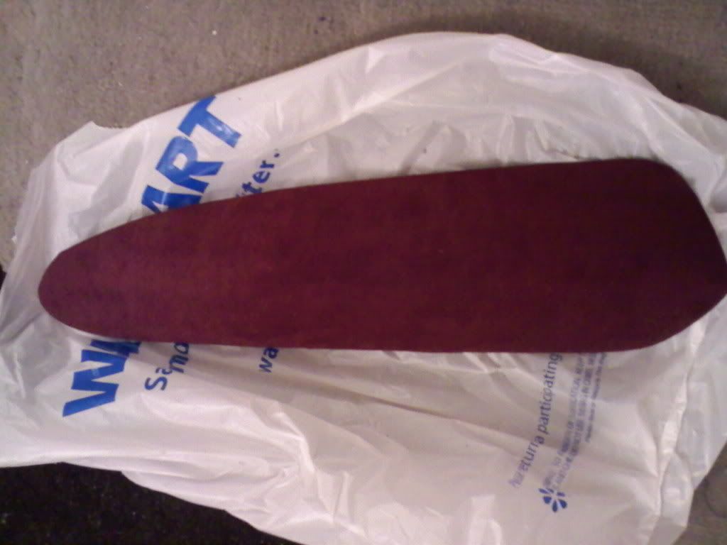

step 5: cutting the fabric
lay the suede face down on the floor or work surface. now take the larger piece of the door panel and lay it on the fabric. now cut the fabric making sure to leave some extra for pulling it tight and gluing.
after you cut the fabric you will be able to use the excess to cover the arm rest piece.

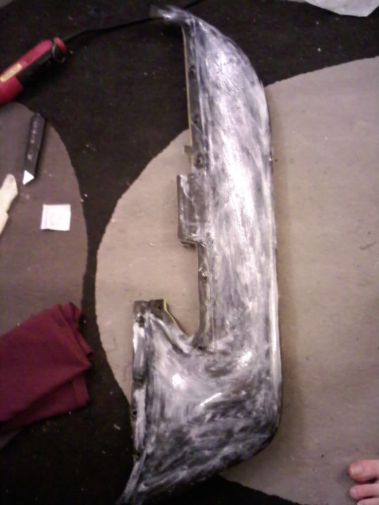

step 6: applying the glue
now take the tacky fabric glue (do not use spray adhesive. it is not durable or tacky enough to hold) sorry for another crappy pic
now throw on that rubber glove and smear that glue all over the surface. try to make it as even a covering as possible and don't leave any gaps.

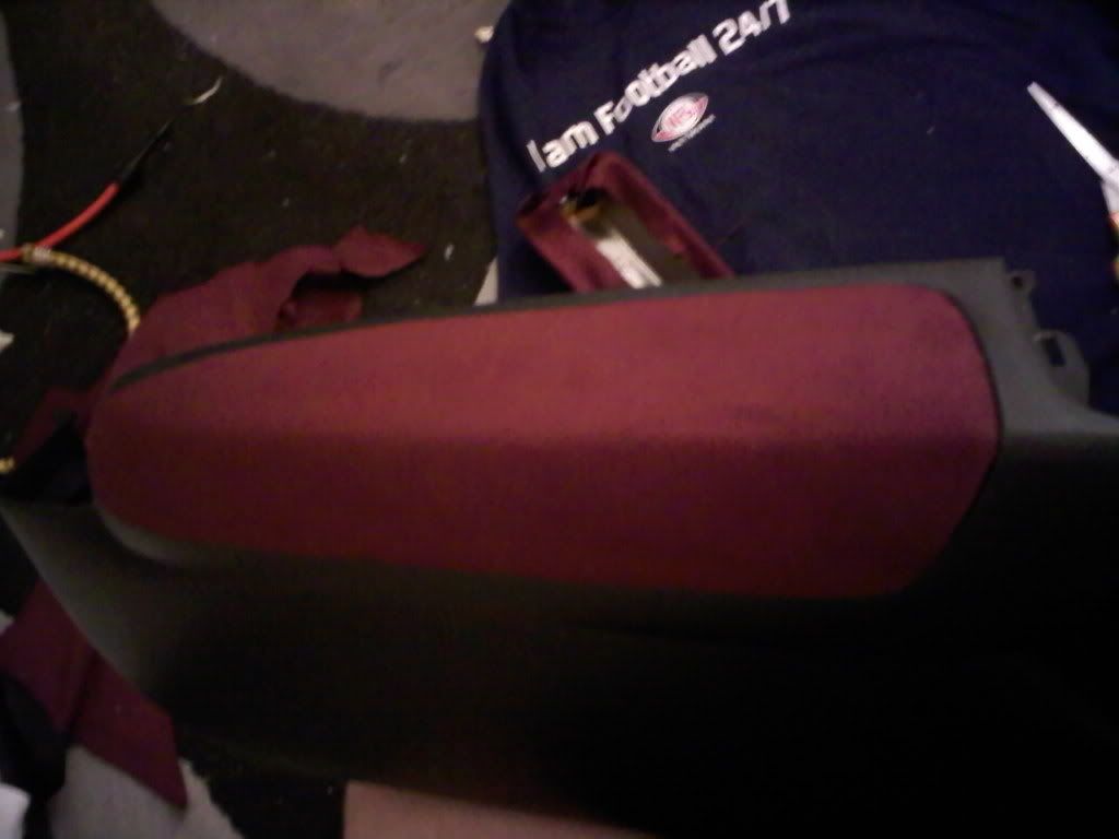

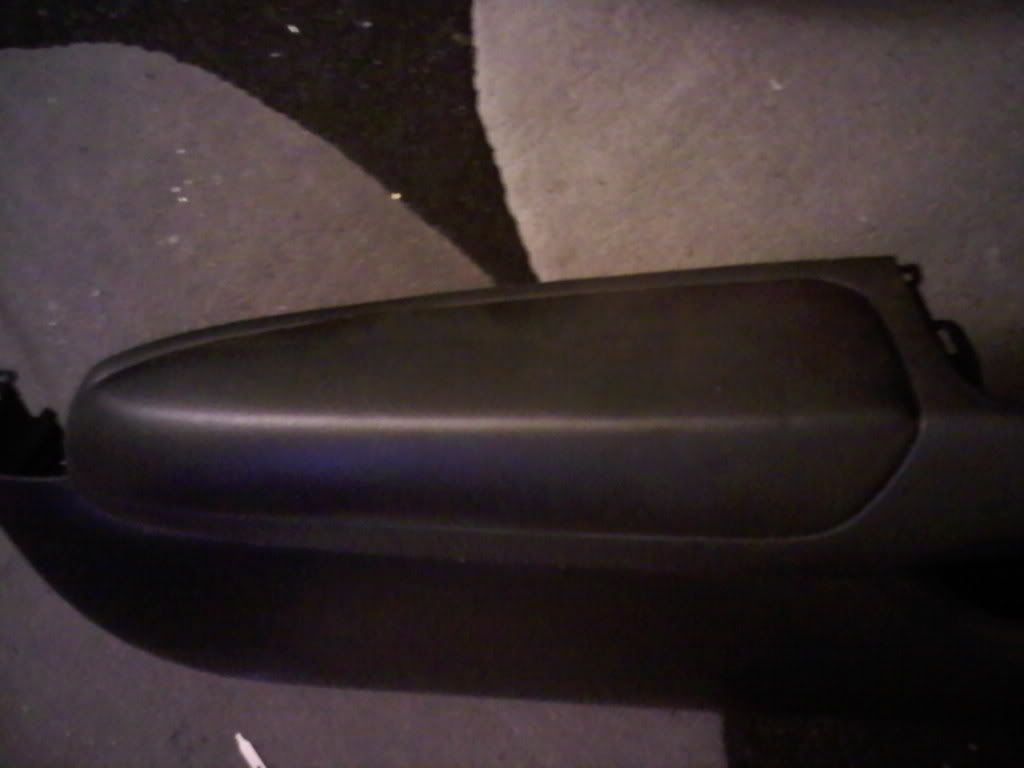

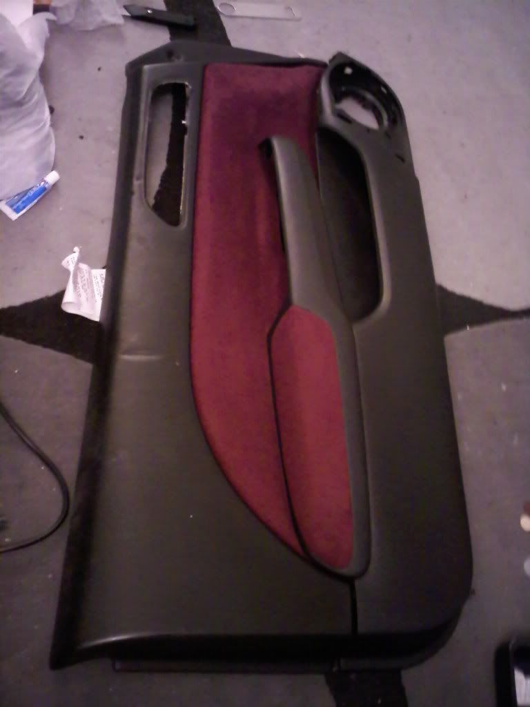

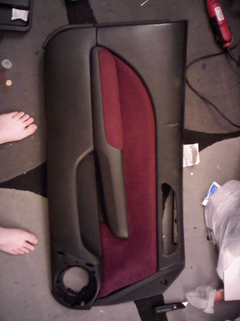

finished arm rest:
step 8: putting it all back together
once all the glue has dried insert the armrest back where it came from:
now to attach the upper part of the door panel it will take much patience. flip the top piece (the part that you set aside earlier) and than take the large piece of the door panel that is now covered in suede and and line it up to fit. you will be joining the parts that you cut earlier w/ the dremel and utility knife. here is where you apply the plastic epoxy (no pics as i have not finished yet :biggrin:) use tape to hold it together while the epoxy cures. you don't really need to remove the tape after the glue dries unless you want to.
your finished product should look like this:
