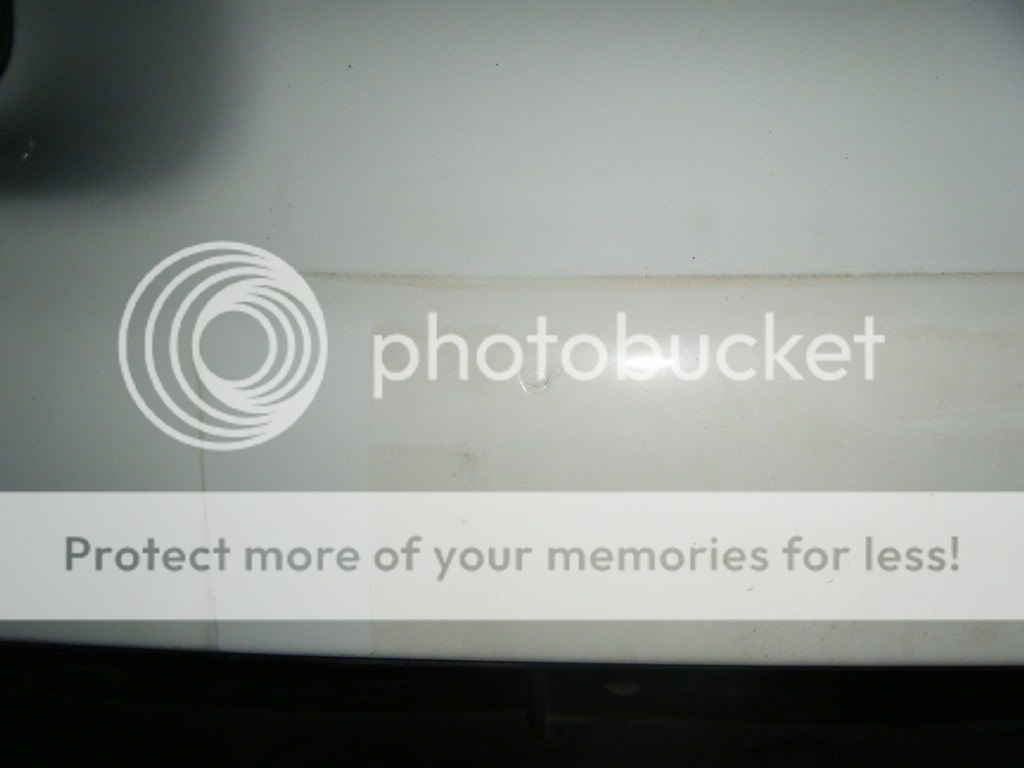

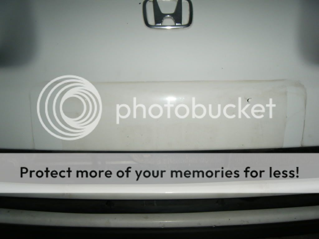

The car came with a front license plate bracket on it. I took it off and scrubbed the area where it was for like 10 mins straight and I think it's stained.. Anyone know how I could possibly clean it up? Or would it be my best bet to just buy a better looking mount to fill the space? Although I like the way it looks without any mount at all ALOT more.

wet sand and buff

there prob is... but youll prob pull paint too and i didnt think you wanted to go the repaint route either lol... i wanna say there is something but i cant remember what it was... but your best bet will prob be the wet sand and buff

try just polishing compound first, only wetsand if that doesn't work. I bet it will though. You can just use a cloth. Abuffer isn't required.

goo gone, give that a shot or rubbing alcohol. Its worked for me in the past

My first try would be rubbing alcohol like previously stated
then clay bar if first fails
then buffing if second fails
then last resort wet sand and buff

i would say use a clay bar
i used brake cleaner one time. it will take off your paint if you use too much but it worked if you use a little on a towl

Rubbing alcohol didnt work so I tried this stuff that my mom uses to clean the stove. WORKED PERFECTLY. lol
