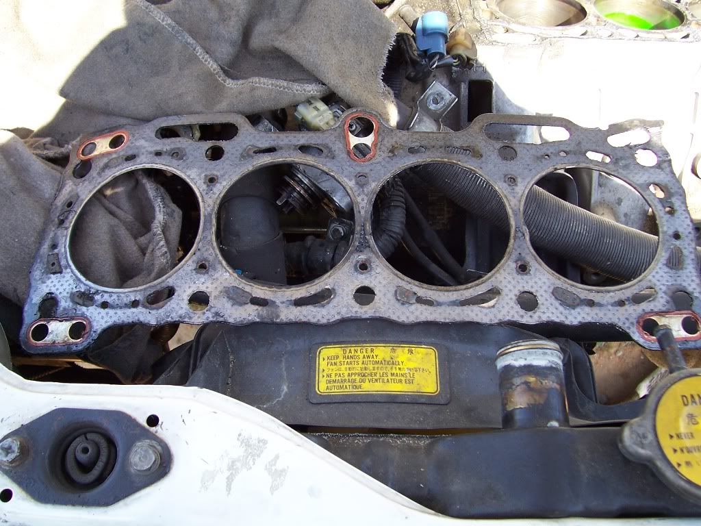

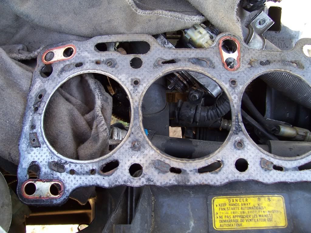

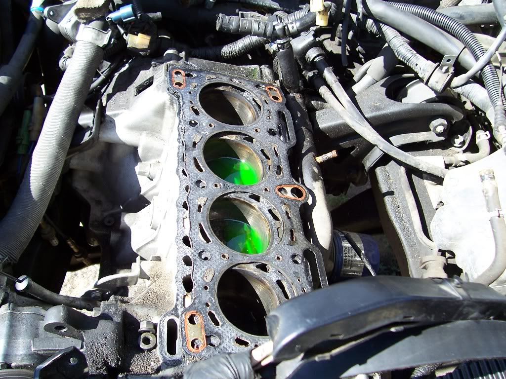

Well, when I bought the white lude it had an overheating problem, the guys mechanic said that cylinder number 3 kept filling up with coolant which indicated a bad headgasket. So I figured it would be an easy fix...it is, but I am just showing you guys what it could look like...And it wasn't JUST cylinder number 3...it was number 2 also, but there doesn't seem to be anything wrong with the headgasket. :jehon:
It also seemed that this engine was running rich as hell, because there is ALOT of carbon buildup on the piston heads and valves...

hehe, my corolla looked like that...but your headgasket looks descent compared to the one we took out of my corolla...

There is no coolant in the oil at all. There is no rust anywhere. I cleaned out all the coolant that was in the cylinders. So it looks practically brand new now. Compression test came back good before I took it off except for cylinder #3 which was very low due to the bad headgasket.
I will find out if the head is warped when I take it to the shop to get that bolt I broke out...

Not had time to read through all of this but that headgasket is definitely fucked.
750 Posts
are you crazy? that head gasket is fucked. there is noting "ok" about that. did you look to see if the block had a crack in it? go get the head plained and put a new gasket in it and keep an eye on cylinder 3 and the coolant level. if you see any oil in the coolant its time for a new engine.

It didn't look as bad as some of the ones I have seen. The block does not have a crack in it.
I am going to have the head cleaned and thoroghly inspected...I was thinking about putting a slightly thicker headgasket on.

Thats a fel-pro headgasket, i recognize it!
It's also quite blown, obviously.
Odds are the block is just fine.
The head should be cleaned, pressure checked, and surfaced slightly.
Use a standard head gasket.

Don't know for sure, but it looks to me like someone tried to re-use an old headgasket.
The orange silicone sealer looks like it was applied by hand. The Honda gasket has no silicone sealer applied in those areas. What do you guys think ?

the silicone is a dead give away that its been touched before. I personally would put new head studs in because it is common practice for me when i do head gaskets. It doesnt matter what car it is to me. its better to play is safe then sorry.
