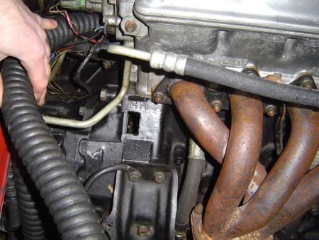

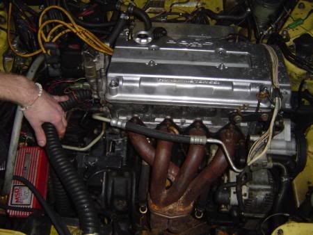

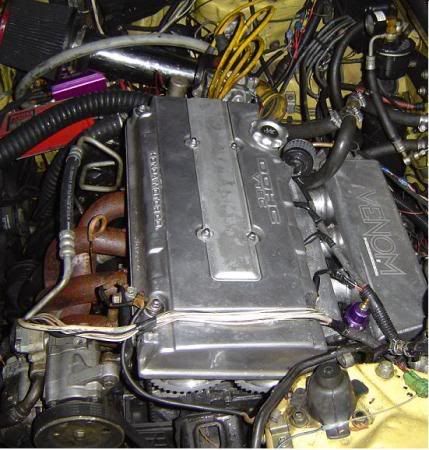

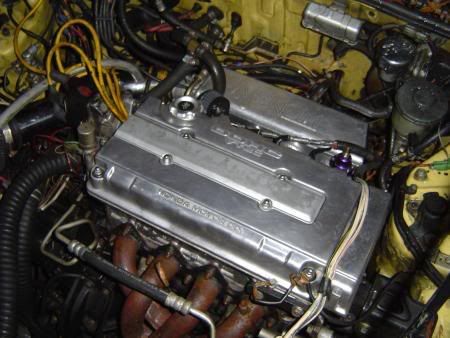

...I tried the ludespeed gasket but it didn't work out for some reason. So I made my own. It has been going strong for about 10k miles. My compression ratio is roughly 13.6:1., that helps out a lot in the midrange with the big cams. Race gas is my friend :smile:. But like I said I dont really drive it that much anymore, the rx-7 gets all the love now. Yeah the engine bay is messy I had to take it all apart a few times and mess with the motor mount. The pics are taken as I was putting it back together, you can see the air intake and the nitrous aren't completely installed in those pics. If anybody is serious about the head pm me. I'll give you the info and the price. Thanks for the interest guys.
