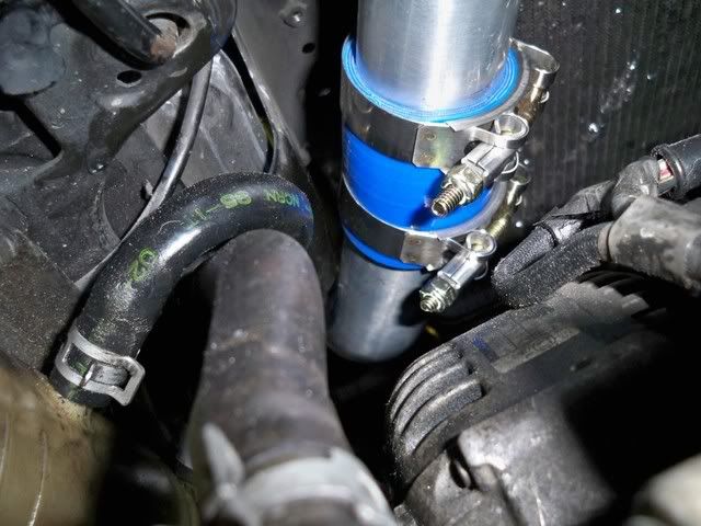

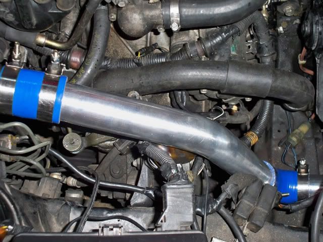

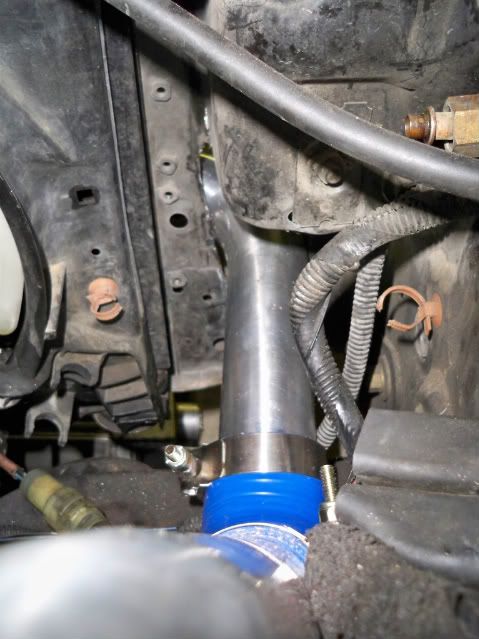

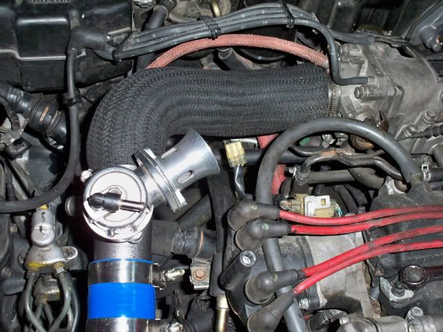

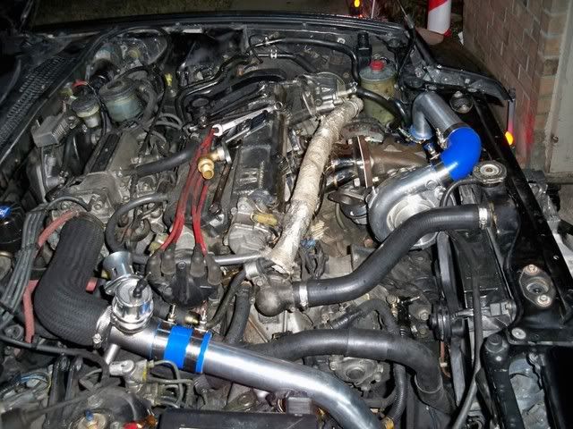

So after buying parts and saving money and buying more parts and saving more money I'm just about done with my turbo build so I guess I will show you guys what I have going. Getting very close to finishing my tune will be done on friday dam wish I could do that. Should be able to pick up my car from a friends exhaust shop and gets oil lines made tomorrow then I think I will be set for saturday. Oh yea just have to mount the intercooler. Let me know what you guys think. Pros cons whatever...

I'm wondering if you checked for hood clearance for the tubing near the rad? It's difficult to judge from the pics, but it looks to me like the hood might not close all the way.

Looks good! Where did you go for your charge piping?

Got the intercooler piping from craigslist pretty cheap was never used. Ya I checked the hood clearance barely had enough room to close it. Just barely had to turn the piping down.

what turbine you got on there? also what manifold? FMIC obviously but sizing? looks like ebay jobbie. Nice work. Hope she goes hard.
411 Posts
manifold looks like a modified ebay h22 job.

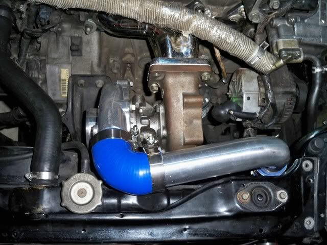

tried one of these myself before going with a custom manifold, i didn't like how close the dump pipe was to the alternator
5,149 Posts
hate to say it but not alot of manifolds out there give that much clearance from the downpipe to the alternator, in all honesty the only real thing to do is at least heat wrap the downpipe, I have had to do this on every setup.

Haha yeah cheapo OBX h22 manifold. Already have car back will try to get more pics of it with the down pipe on very tight fit. And yea definitely will wrap the down pipe with exhaust wrap but that should do the trick. the front mount I have is pretty small came off a friend of mine dsm starion do not no the exact size but was cut and made smaller should be able to post pics of it mounted tomorrow.
The turbo compressor is .50 and turbine is .63 don't remember but I think the trim is a 57 I don't remember.
And for the dump tube it isn't going to go towards the alternator will go towards tranny side will post a pic of that to when I finish the dump tube. Have a question about that I want to know were you turbo guys are ending the dump tube because I don't want it to burn anything so please any input on that will help.

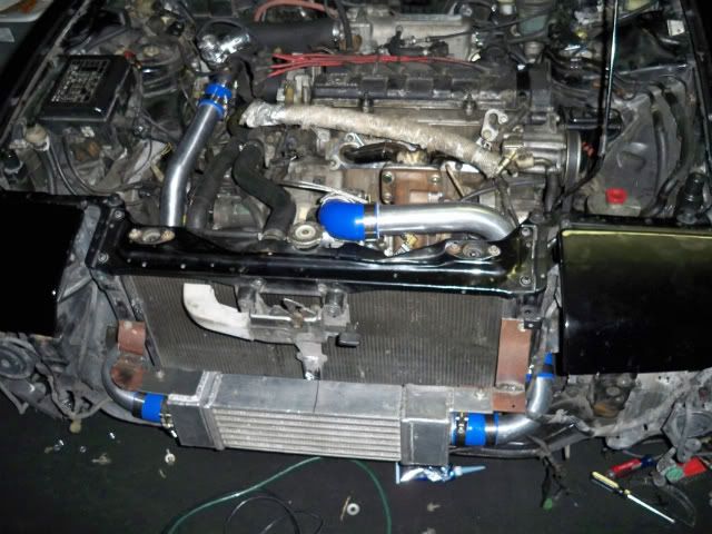

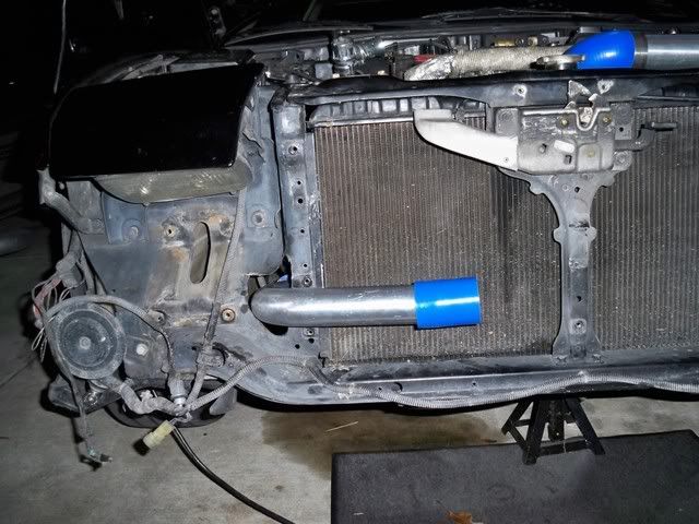

I finished connecting everything yesterday so sometime today I'll try to get some pictures on here with the front mount only thing I haven't put back on is my bumper. I was able to start it and found an oil leak from the feed line rite were I had it connected to the turbo should fix that today.

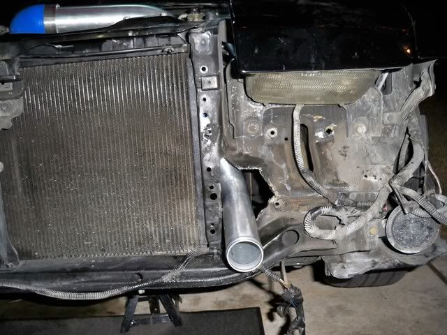

Threw in a pic of the intercooler on put in first post. Should be able to put up some updates this weekend won't be able to finish car up till then stupid oil line lol

Looks good! Why such a small intercooler though?

Low boost plus the one I had originally bought was much too big. My friend gave me what I paid for the one I had and gave me this starion one should be fine for know. That and intercooler piping will be the first things I will upgrade.
