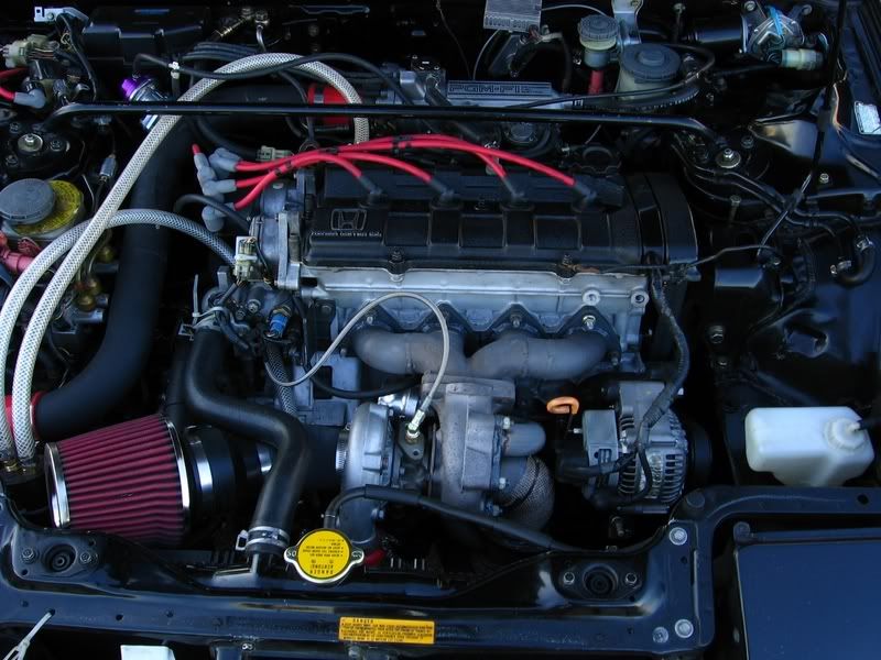

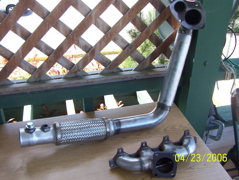

4. Here is a picture of the www.LSDMotorsports.com T-25 Manifold and Downpipe:(*note: LSDMotorsports no longer supports 3rd gens - this is for reference only)
And this is what it looks like once installed:
These parts are made of all stainless steel metal and are of good quality craftmanship. You have other options, I am only using my setup as an example for all you wanting to know - parts etc..

Here is a Treadstone Cast Turbo Manifold for the H22 that can be used on the B20a5/B21a1 heads.
Here are pictures of how Turbonetics1 routed his intercooler piping and still kept his A/C.
Completed!!!!

Here are Pics of those 3rd Gen'ers who have complete Turbo setups:
Tonbaker -
This was Tony's orginal setup Non-intercooled however; he had an www.snowperformance.net - Boost Cooler kit on his setup which was what he used to cool his charged air to the engine for two years non-intercooled. The stage 1 kit costs $299.00.
Here is Tony's rebuilt B20A5:
Tony's Setup:
Engine:
b20a5 block
b21a1 head, mild portjob
B-18 intake cam
B-16 outer valve springs
Pauter Rods
Weisco Pistons 8:5:1
Turbo Setup:
Precision SC61
Tial 38mm
HKS SS
Gigantic FMIC
Alky Control Methanol Injection
NX 65 Shot
Ludespeed Manifold
Ludespeed front engine mount
Tuning Setup:
550CC injectors
Hondata S200
Walbro 255 lph pump
Bigger fuel lines and NO banjo fittings anywhere.
Exhaust Setup:
3inch all the way back
Apexi N1 muffler
Drive Train Setup:
ACT XT Pressure Plate
ACT 4 puck race disk
Stock Lightened flywheel
Weight Reduction & Transfer:
Aluminium Sunroof replacement
Aluminium front bumper support
Lots of misc removal, AC, Power Steering, Heater Core, Sunroof, Seats, SeatBelts etc...
Power Output Updated 11/08/06:
Daily driver 400+whp and 380lbs torque 3rd gen turbo lude.
Updated power curve after Dyno - October 17, 2006
This was 20lbs of boost with a 50shot.
Note: Above 20lbs the car was running super rich (10:1). It needs to be tuned some more. So hopefully after my next tune session i'll make 380 on boost alone.
Slowly but surely.

CADster's formerly Bgerk's Setup:
www.LSDMotorsports.com - Manifold Kit(DIY) I had welded togther
Intercooler and Piping
Rebuilt and Polished 14b
Polished DSM BOV
Downpipe
SAFC II- for Tuning
Wired-up MSD-BTM - for Tuning
GM 2-Bar map sensor
walbro 255lph fule pump
modified Powersteering line to go over and down on the driverside
Zex Plugs
*Kept all A/C, Powersteering, Cruise Control.
