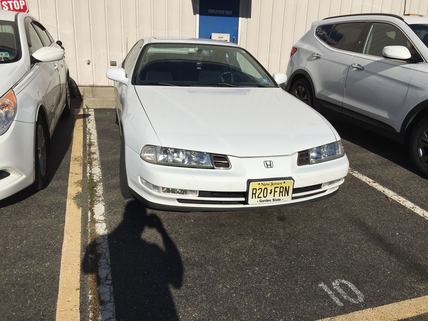

Heres a picture of the car after I replaced the banged up fender and blinker/running lamps. Shes looking pretty good.
