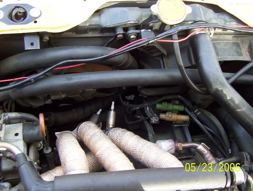

4. Here is a picture of the www.LSDMotorsports.com T-25 Manifold and Downpipe*note: LSDMotorsports no longer supports 3rd gens - this is for reference only)
And this is what it looks like once installed:
These parts are made of all stainless steel metal and are of good quality craftmanship. You have other options, I am only using my setup as an example for all you wanting to know - parts etc..

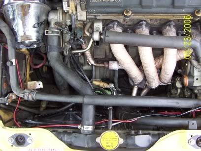

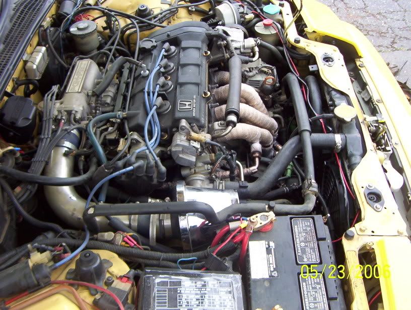

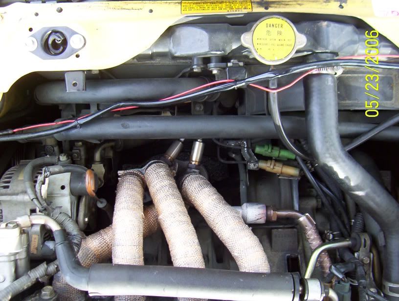

I decided to upgrade my Radiator fans for more room and better cooling before I put in the Turbo here are the pictures and a little write up:
Ok here is some pics to give you an idea of what I have to contend with:
So what do you think?? Should I pull the upper hose and just let some leak or what??

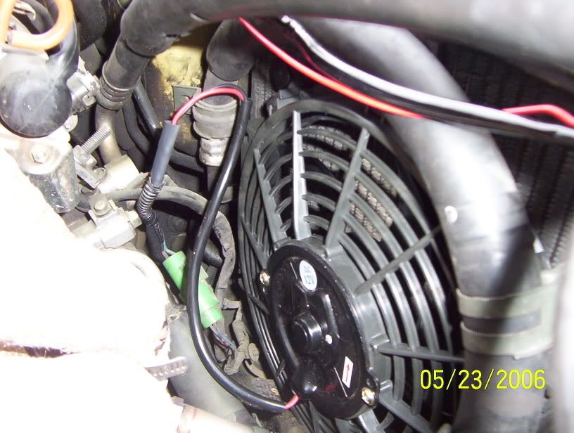

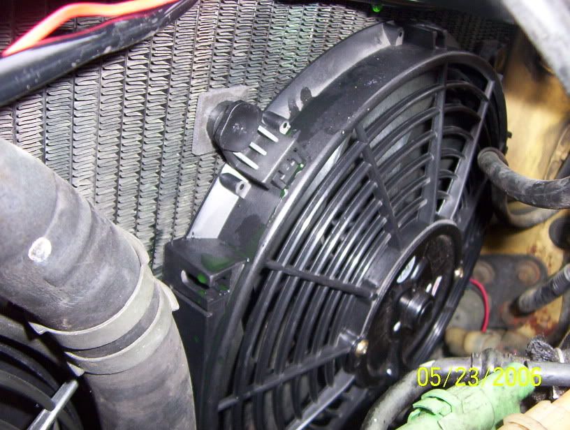

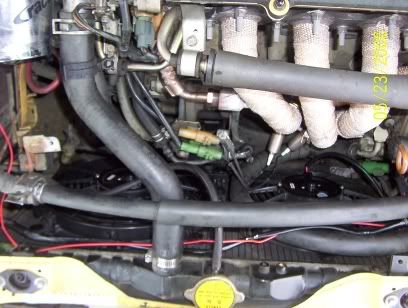

*Update ------------------------------------------------------------------------------
Ok, it took me a while(2 1/2 hours), but I got it done and it works great! Definitley pulls alot of air and is much quiter! So, here are the pics:
I like alot!!!!!!! I recommend everyone do the upgrade, it free's up alot of room for future upgrades .
Here is what to do:
1. You have to unbolt 4 bolts on the top of the fans, each one has two on top and then three at the bottom of the radiator. Two of the bolts are just a untighten situation and the third is a complete removal.
If you have A/C like me, you will need to unbolt two of the A/C lines from the smaller fan, and unbolt the little funnel looking thing that shoots air to the Altenator.
If you are an Automatic like me, you will need to unbolt the two lines on either side of the green and white O2 sensor connectors. You will need to be able to move them when it comes time to remove the fans.
2. You will want to get a 90 degree angled pick(they are cheap tools you can get at any local hardware store) to take off the connectors, which are way down in the engine bay so get ready to squeeze your way thru.
3. Once you have the connectors off and all the bolts undone, you will need to remove the top Radiator hose and overflow hose and bend them away and put a rag on the top hose as not to loose to much coolant, the little one will just bend away and keep it facing up.
4. Now start with the bigger fan first and just wiggle it back and forth and make sure to look at every angle as it is coming up because it will snag on something and stop coming out. Then once you have the main fan out, start to work out the smaller fan toward the left where the bigger fan was and then pull it out the same way.
Walla!!!! there out. And now just install the fans that will replace them. Oh yeah!! Make sure to cut off the OEM connector from the OEM fan so you can butt connect them to the upgraded fans.
The Blue/Black wires on the OEM fans are (+) and the Black wires are (-). Just use butt connectors and I recommend getting some of that heat shrink tubing to cover them after they are connected.
And just an added note: You can actually fit two 12" fans side by side(as you can see from my pictures), there was more room than I thought when I ordered these two. It does not hurt to have bigger fans pulling the same amount of air or even go with a 14" and a 12", I will probably end up changing up later on, but this will do for now.
FYI: The A/C line that you see going over the upper radiator hose is not suppose to do that, I removed the hose again after I took pics and placed it back under the hose where it was suppose to be in the first place.(oops!!)

3. 3rd Gen DSM Ghetto Setup:
For those of you who wanted to know, you can successfully install a complete Eclipse DSM Turbo system in a 3rd gen and get it to work. His setup up was from a 91 Eclipse DSM. This setup is from a member by the name of Fisher Price.
Here is a picture of the only one known to date to make it work:
Quote: "Well for those who said it couldnt be done...here it is....im finished and here are the pics i promised...it fits like a charm...there was some minor grinding i had to do to the block to get it to fit but its nothing major...all minor work...the front mount will fit but only with the bottom bolt only...the top half of it would have to be cut off....O2 housing clears the alternator fine but i think i will make a heat shield for the manifold and the O2 housing so i dont fry the alternator and the power steering line...not bad for 10 bucks on the manifold...free turbo and 4 hours time of beta testing....for all you who said it couldnt be done...well its just been done!!".
4. The Second DSM Turbo Installation to date(5/14/200 :
DSM Turbo Setup Installation ( 1 2)

Here are the pics:

Planeman01 - updated September 18, 2006
Planeman01 had said he thought he knew what setup he wanted and then when he acutually got it, he wanted something different. He also said, after it was Professionally Tuned, his engine blew because we had a cold snap up here in Seattle, which in turn caused an extra 1psi higher than what his car was Tuned for. So, make sure that you know your environment also when going this route. Every place is different and a car will respond differently to different environments especially when it comes to Performance cars.
Planeman01's Setup:
Engine:
Stock Block and Head
action 2ms clutch
rebuilt tranny
new clutch master cylinder
new slave cylinder
Turbo Setup:
Straight T3 .42/48
Ludespeed manifold with 2000deg F coating
Ludespeed downpipe
TiAL 35mm wg .5bar spring
2.5 inch exhaust
a muffler that i thought looked cool
dsm injectors (390 cc)
walbro 255lph fuel pump
tuned on crome
ludespeed front motor mount
new radiator
jhonny racecar FMIC painted black
2.5inch charge pipes
golden eagle sandwich adapter
stainless braided oil feed
autometer boost gauge
greddy type s bov
blitz bual TT turbo timer
Power Output:
i put down 179hp atw and 187 tq. on 5.5-6psi
