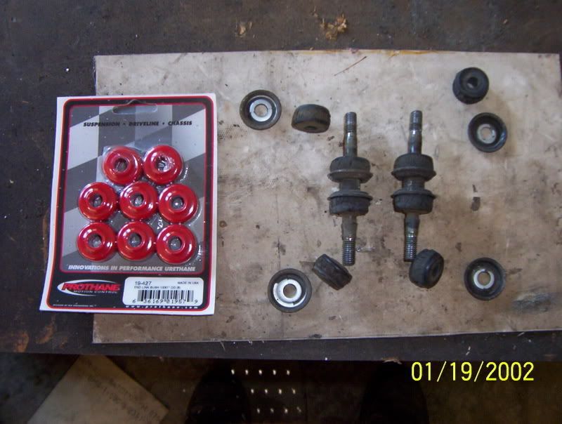

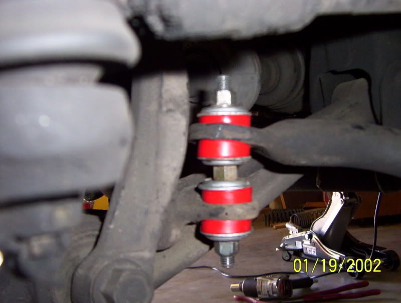

I found some universal polyurethane endlinks from Prothane. I purchase the set from www.ajusa.com. It cost $6.10 + $8.50 shipping(man is that funny) but I like them, the front end feel more solid, and I when I go over hardbumps on the road, it does not give a hard metal bang like it used too. It absorbs the bumps better, now to get on the other bushings to tighten up the whole suspension.
Here are the details:
1. Bushings: Prothane #19-427 1/2" X 1" OD - color Red
2. Tools: 12mm socket, 3/8" rachet or air rachet. (1) 12mm wrench
3. Floor Jack, Jack stands, grease, shop towels, etc...
Update: One of the members(1988HondaPreludeSI) found another kit with the washers here is the part# 8-401
Here is the picture:

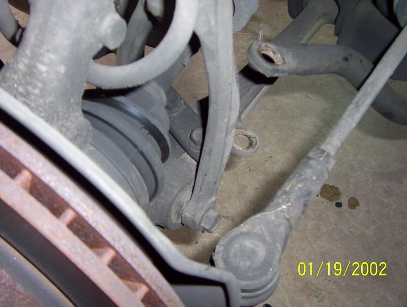

Get the car up in the air and take of those wheels.
Here is a picture witht the old endlinks off:

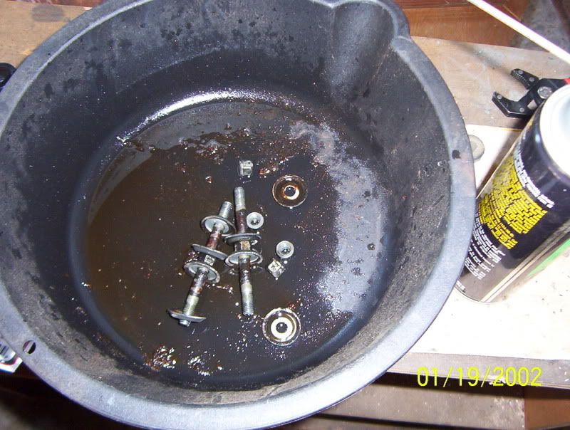

And here are the old endlinks, man they were tore Up!! And the new bushings that will be going in.
I recommend cleaning the old bolt and nuts and washers, but its up to you. I used regular brake cleaner, works very well, and you should get a cheap wire tooth brush style. It will help get off a lot of old road dirt and grime.
Here they are after cleaning. I did not have wire brush so an old tooth brush did only so much.

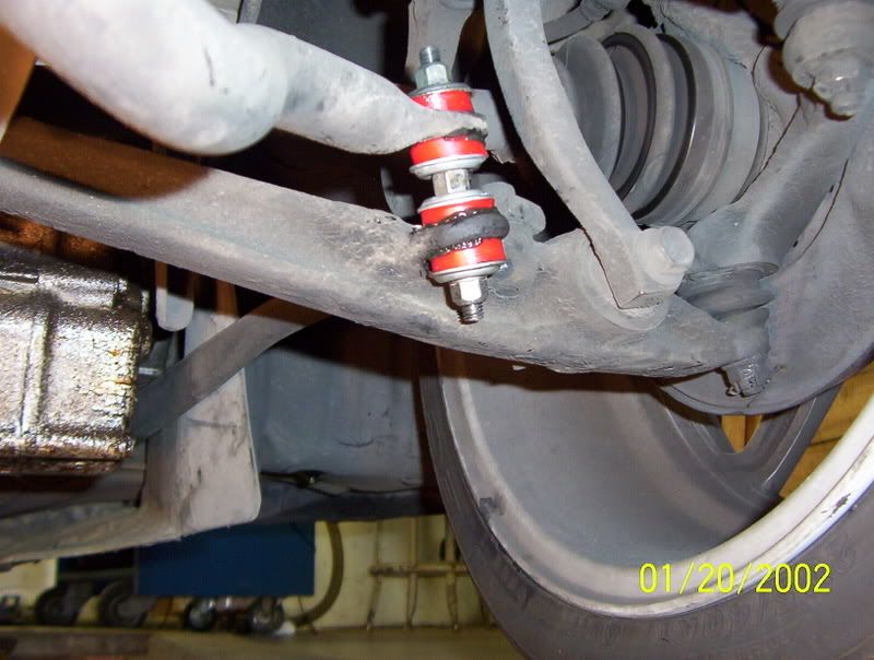

I was just testing out, out how they would go in before I acutually installed them.

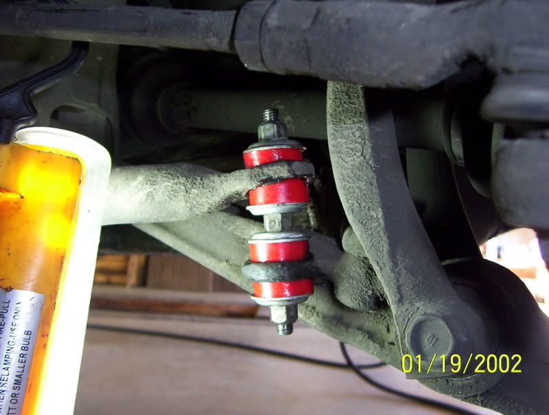

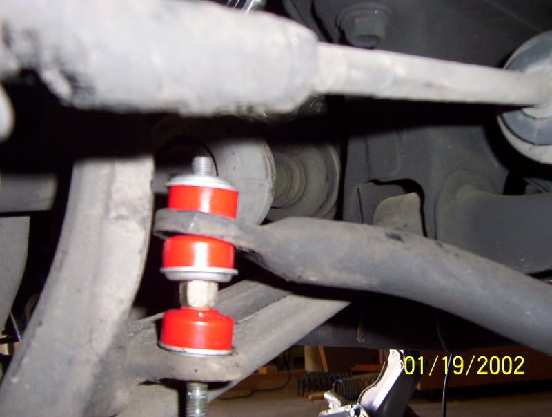

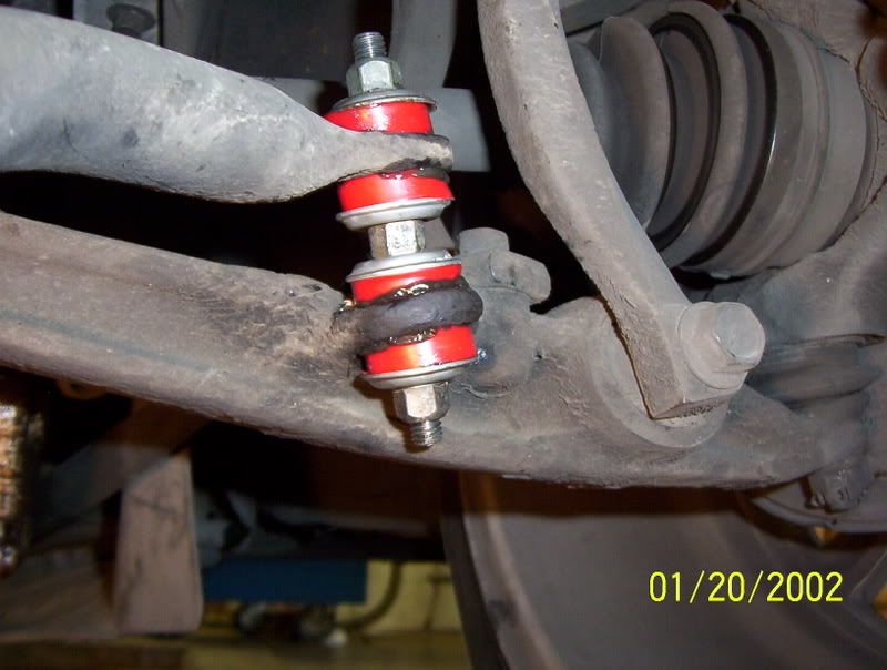

Here the are installed:
With tires on and on the ground at full compression:
I know we all like pics, so enjoy and if you have questions, don't hesitate to ask.

Acutually they did not move at all, I checked after a run around the city. I recommend buying bigger washers than the stock ones. The bushings is just right at the edge when you install them and then after you bolt them down and tighten them, you will see the bushings slide out just a bit, and then it stays there.
The factory washers were not meant to handle these beefer bushings, and I am going to replace them with wider washers.

#35 ·
#37 · (Edited)
you have to sand those bushings as you do the universal bushings from energy suspension due to stock bushing washer size and front endlink. Unless you want to power sand them and are ordering other prothane bushings I would just cough up an extra $5 and get the ones with hardware made by energy suspension. Its all in my "End all polyurethane bushing thread" also I think autozone stocks them in stores but if not they will order them prepayed and shipping is free and they are cheap like online price cheap. Plus there are pics of mine installed and Forza's who omitted the pipe collar between upper and lower bushings because he is lowered. No offense sean but times change we have come a long way baby. These are buy and bolt on. Plus stronger than stock endlink. Just make sure you put bolt head on bottom and nut on topside so the bolt doesn't drag.
$15.99 at your local vautozone part number: 16.8104R, R is for red bushings and if you want black replace the R with a G. As is all es bushings.
