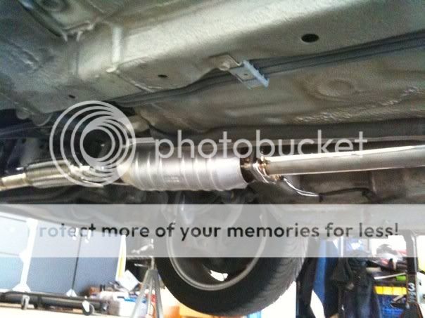

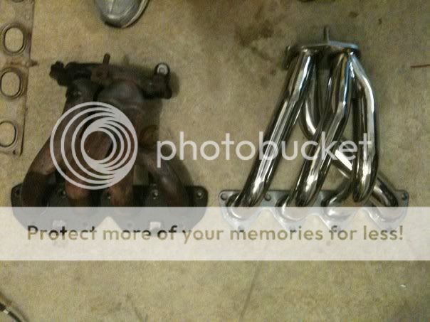

I just did a full header back swap with Megan Racing Header, a Magnaflow high performance car sounds cat, and Megan Racing full cat-back NA type exhaust. Over all I give it 4 out of 5 stars.
Pros~
- Fairly Cheap compared with greddy and HKS
- Full polished stainless steal
- 2.5" piping, 4.5" tip
- Beautiful welds
- great fitment
Cons~
- The is fairly small compared to its competitors
- It's a little louder then I would have liked it to be
So did didnt take to many pics.. probably should have thought about it but i took them with my iphone and i wasnt about to get grease and shit on my phone..
As for the swap. Im glad I decided to do header back because shit would have gotten really messy if I stuck with the stock header. the flanges all the way down the pipe were pretty much welded to one another. once I got everything out, putting it all back together was the easy part.

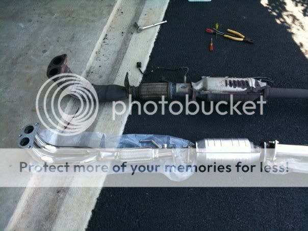

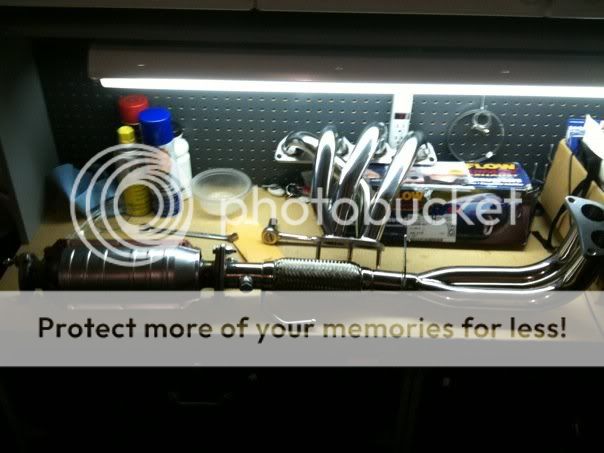

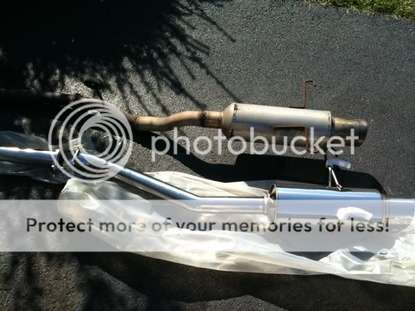

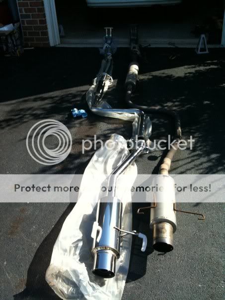

Laid out before pulling the car in
old Vs. New

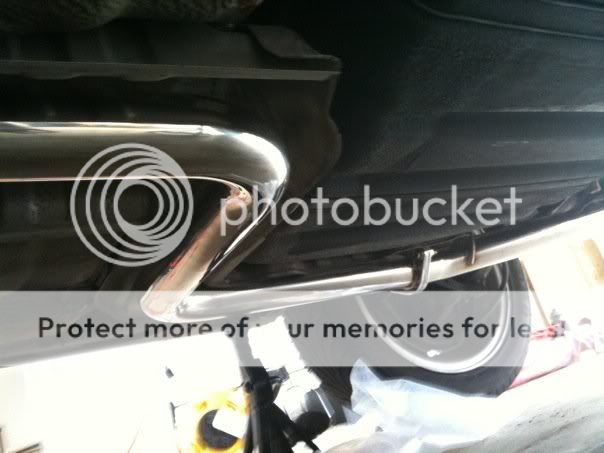

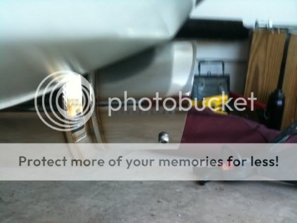

Megan tip, I like the clean flush look it has with the bumper!!

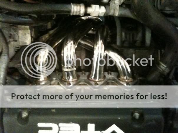

mandrel bent
Resenator
Magnaflow cat
Flex pipe
Old Vs. New
All in all this was a very easy process, it took me about one day to finish because I had to get a new sencondary O2 sensor.
I also needed to buy three bolts w/ nuts and washes for the flange from the header to the cat (Megan did not provide these)
The whole project cost me about $850.00.
